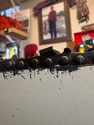

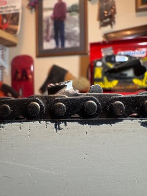

Hello, I'm looking for constructive criticism if this is acceptable for a square grind. I'm converting this chain from a circle grind. I think I'm finally starting to figure out how to square grind by hand, but I want to make sure I'm not just mistaken.
Pferd 5/32 file and Pferd double bevel file used.
Sorry if the photos are blurry, the phone overcorrects, leaving too much reflection or not enough.
Thank you for the response in advance.

from what i can see in the picture that will cut good. as long as the side cutter and top plate meet at the point on the inside it will cut. the thinner the top plate is will make it cut fast and dull quick. if you make it thicker or mor blunted like a chizel it will be stronger while cutting well and wont dull as fast. the top plate angle will also contribute to how fast it will cut and how smooth it cuts. the more squared it is the smoother it will cut but it will slow it down slightly the more pointed it is will make it cut faster if the saw has enough power but it will chatter more. the kind of wood you are cutting makes a difference too. i personally like my chains more squared off so they cut smoother. i also just go for a chain that will cut hard wood well. if a chain will cut hard wood well it will blast through soft wood really well

Hello again, this is not my original photo, but is from a reputable porter. By chance, when first trying to learn how to square file, I took a true Pferd triangle file, not the hexagonal three sided Pferd file, and ended up with this tooth. There is no top tooth, like circle or square grinds I've seen, but it looks pretty good for cutting. The porter says it cuts well, and calls it a square grind. Is it accurate to consider this as a type of square grind?
The reason I ask, is that is super easy to achieve, just using that large triangle file at a slightly dow ward angle, similar to the 45/45/45 tilt, except you only keep it
Thank you. This is good information for me to know. I think I will work to have a less aggressive angle, and be okay with slightly slower cutting.

Yup that’s a square grind , done on a square grinder,

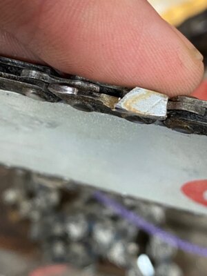

IMG_7516.jpegWhat causes this? I’ve seen it before on other peoples chain.

View attachment 457145What causes this? I’ve seen it before on other peoples chain.
I've only ever seen that after ground contact. I have heard about wind blown grit in bark, but we don't have much of that here. That chrome layer is the hardest part of the tooth. That didn't happen from cutting wood.
