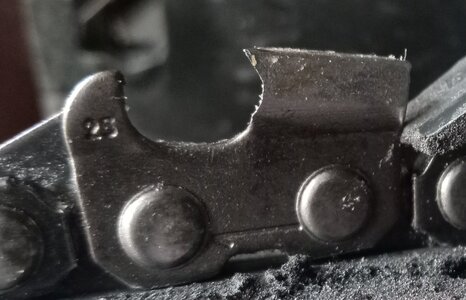

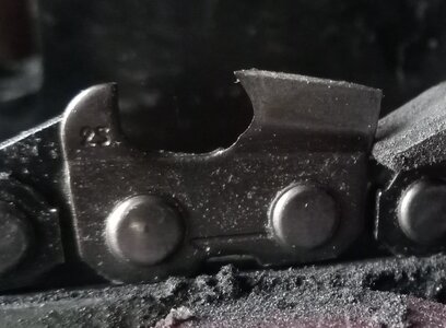

Got some uglies in for grinding, another loop was severely rocked but I didn't take pictures.
This is the semi after my grinding.
I didn't feel like swapping wheels for just one .325" so it got a big-C from the 3/8" chain wheel.

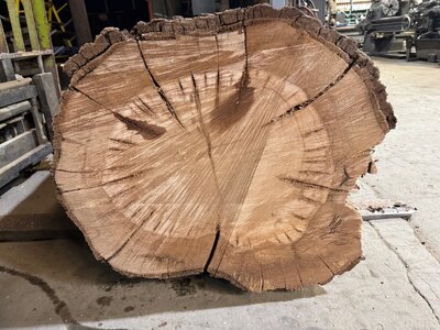

The middle still needs to dry, it’s wet and fermented.
Turkey oak, which I prefer for firewood, won't even crack like that while in log form.
Even after 2 years sitting out in the open it'll shed its bark, but once bucked & split it still needs to season at least 2 years to burn well and long.
Split & bucked it can withstand the tooth of time and seasonal erosion for easy half a decade plus.

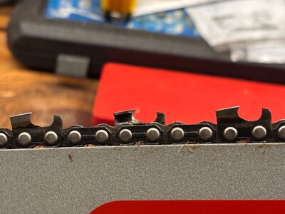

I experimented once before with Xcut/Hexa flat faced cutters but titled more vertical for durability. Need to revisit. Probably will go grinder, then flat file in the field …or 1/4” round file
@Squish9
Go for a "J" ground profile instead of a "C"!
I noticed incresed cutter durability with negligeble drop in cutting performance.
Also, Husqvarna Full Chisel X-Cut is Your friend!
C-series , IIRC.
Semi chisel in any brand does nothing for me.
