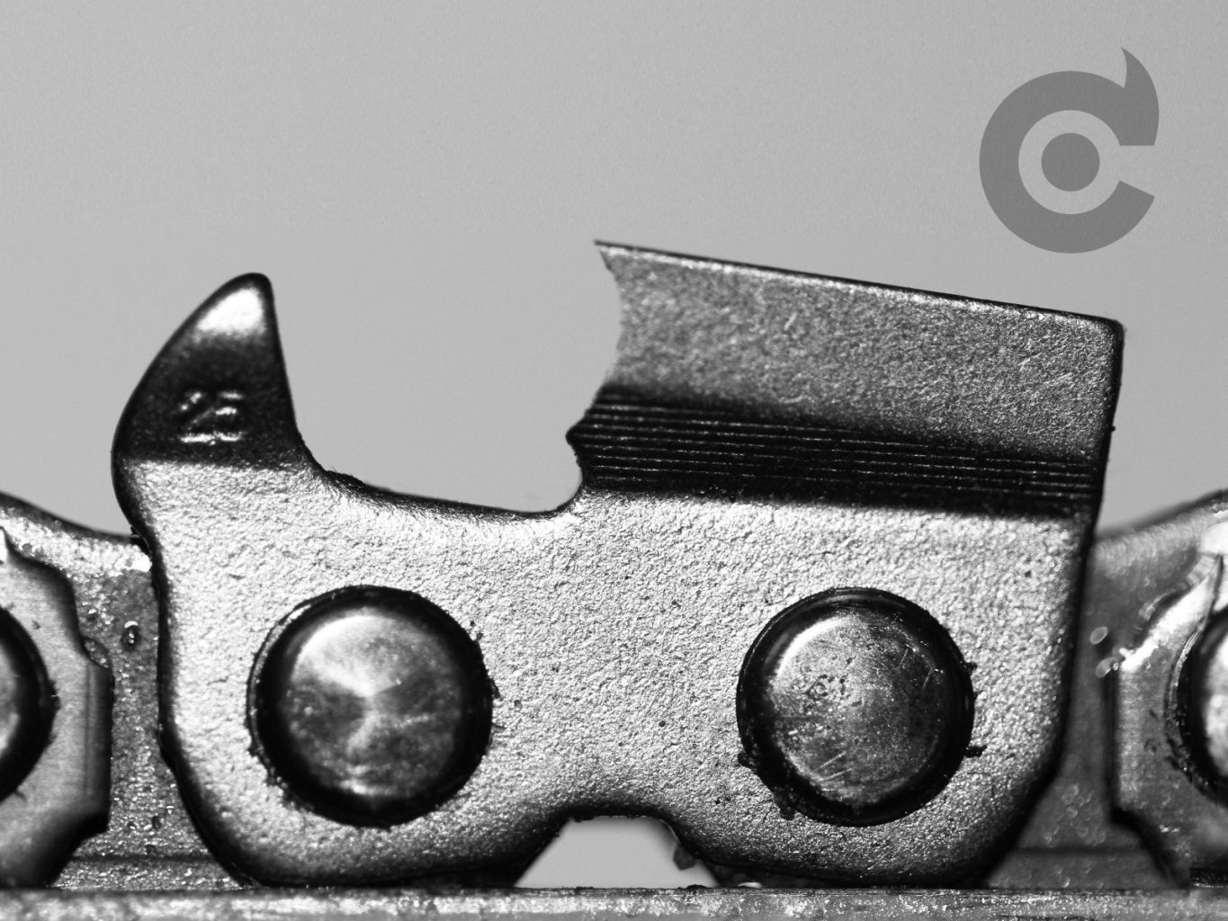

I had an old 28" chain that I got with a saw, previous owner filed the rakers down way too low and the cutters were sharpened all wonky. Yesterday, I evened everything out on the grinder. Still had very aggressive rakers, so I decided to throw it on 038 Mag II and see what a torquey saw would do with it. Needless to say, I was pretty impressed. The saw just ripped right through the green pine I was cutting, self feeding, threw chunks for chips, and threw 'em far. Old Oregon 72. 25 top plate, 60 tilt, 10 down.

It will cut for sure. It doesn’t look too much different on the side plate than when I tried filing round at the square angles. The top plate will look similar to the side plate. Noodling it was super fast and didn’t clog a normal width clutch cover. IMG_0364.jpeg

I haven't experimented enough yet, but especially for cutting dead wood and on the larger saws with skip chain, I'm finding having a more square profile to the top part of the cutter, followed by a rounded, slightly undercut [to the upper bulk of the cutter] bottom going into the gullet makes for a stout and lasting chain, even in dead/dirty wood full of acorns/gravel/sand/dirt/rot.
