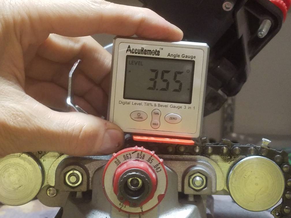

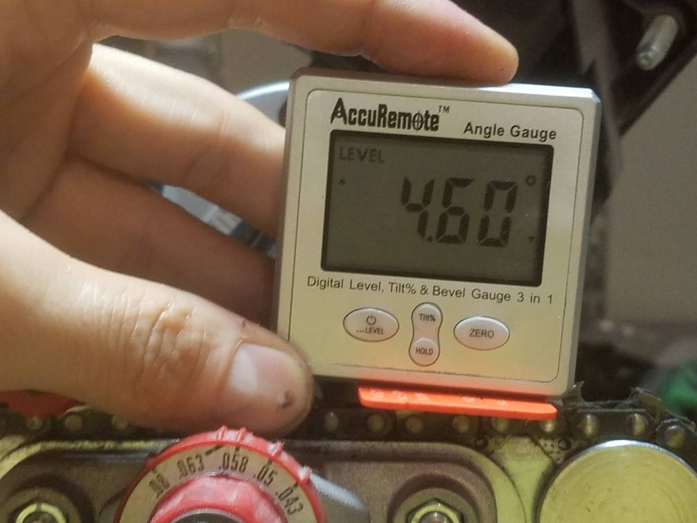

That video inspired me to scrutinize the raker depths. I don't have a progressive raker depth tool, and they wouldn't work on this safety chain anyway.
But I do gave a level-based angle gauge. I found the angle varied wildly, from around 3 to 6, but mostly in the 4's. On a new semi-chisel 3/8 chain I was measuring in the 6's
Going to try lowering them to a nice consistent angle (6?) and see how it goes.

Well I lowered the rakers until the angle was at roughly 6 degrees on the digital level. And it fixed it!
Well, sort of. Self feed was decent but it was too grabby now. It wasn't terrible but it was pulling inconsistently, a little annoying, and I suspect hard on the saw.
I then attempted to fix the aggressiveness by hitting the cutters again at less of an angle. This was a total fail. The saw went back to not feeding at all. I think I was just too hasty and didn't get all of the cutter at the new angle.
I sharpened another full round - cutters at 60/30/5, and rakers lowers again back to and angle of 6 - 6.5 degrees. But the test cut will have to wait until tomorrow after work. I don't think the neighbors would appreciate me running the saw at 1am. :D

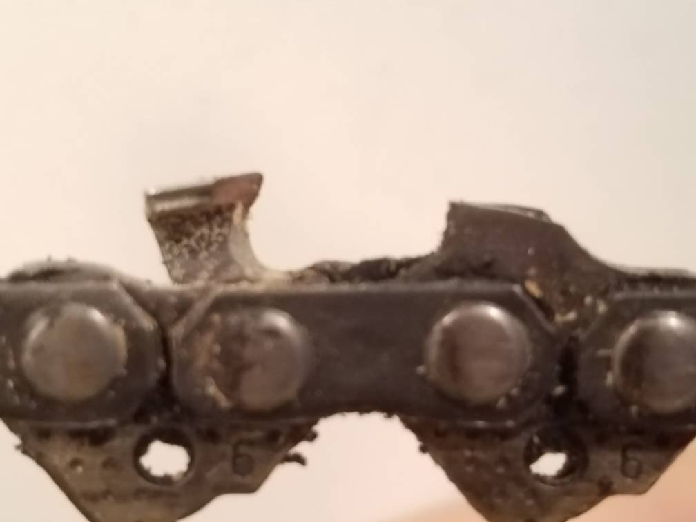

I came into this thread a bit late. I noticed this picture -
It appears the raker shape is not steep enough, it's too flat. The 'cutting angle', say 6 degrees, will be established in a trigonometric function from the TIP of the cutter to the CONTACT POINT of the raker to the wood.
If the raker is flat, the contact point will be at the front of the raker. In which case, the cutting angle will be reduced. If you shape the top of the raker to move the contact point to the rear of the raker, the cutting angle will increase.
Your explanation of the raker top angle helps me understand how the tooth works.
A while back we had a discussion on the raker shape itself. If you take a look at say a fresh raker on RSC you will see a distinct 'shark fin' shape from the factory. The reason is to make the chain a bit more sensitive to the wood type and to be able to 'adjust' the cutting angle.
When a raker is 'thin' it will sink deeper into soft wood, likewise if the raker tip is more of a 'point' it will also sink deeper into softwood - the result is an increase in cutting angle when the chain is working softwood.
In Oz I usually cut tough hardwood and even though the raker has a fairly sharp point it just skips across the wood. On softer wood it will take a bigger bite. In fact, I was cutting up an old 'Custard Apple' tree (definitely softwood) and it took such a bite that the saw slowed down. I don't know how thick the chips were, but they were thick.
