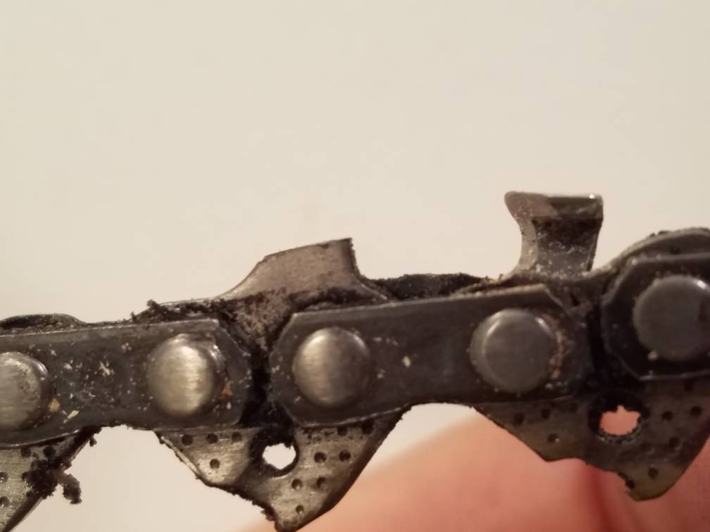

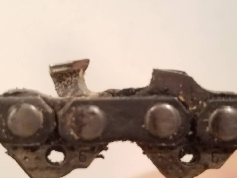

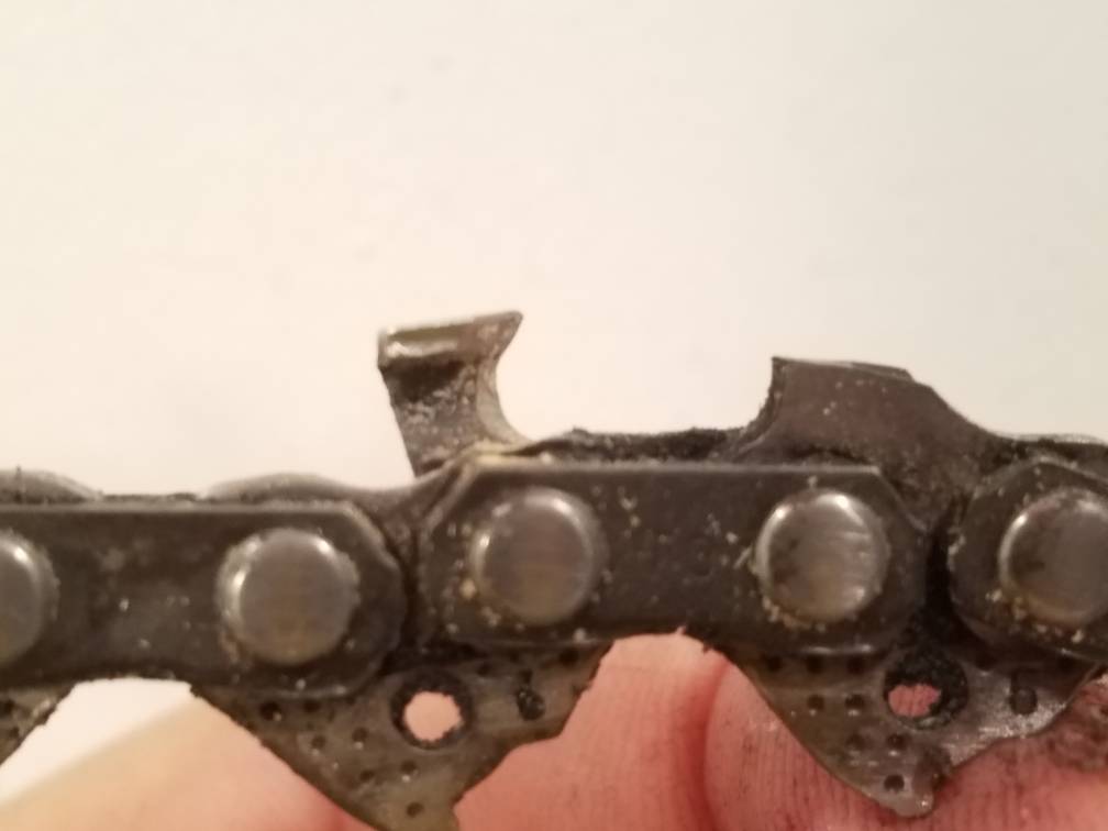

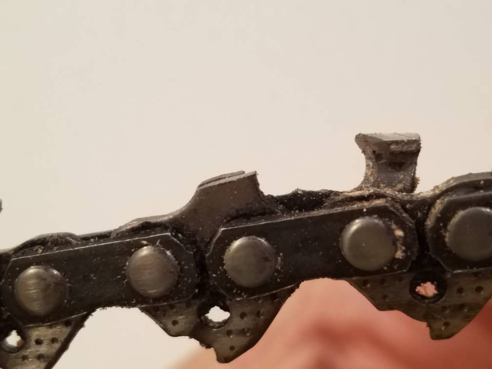

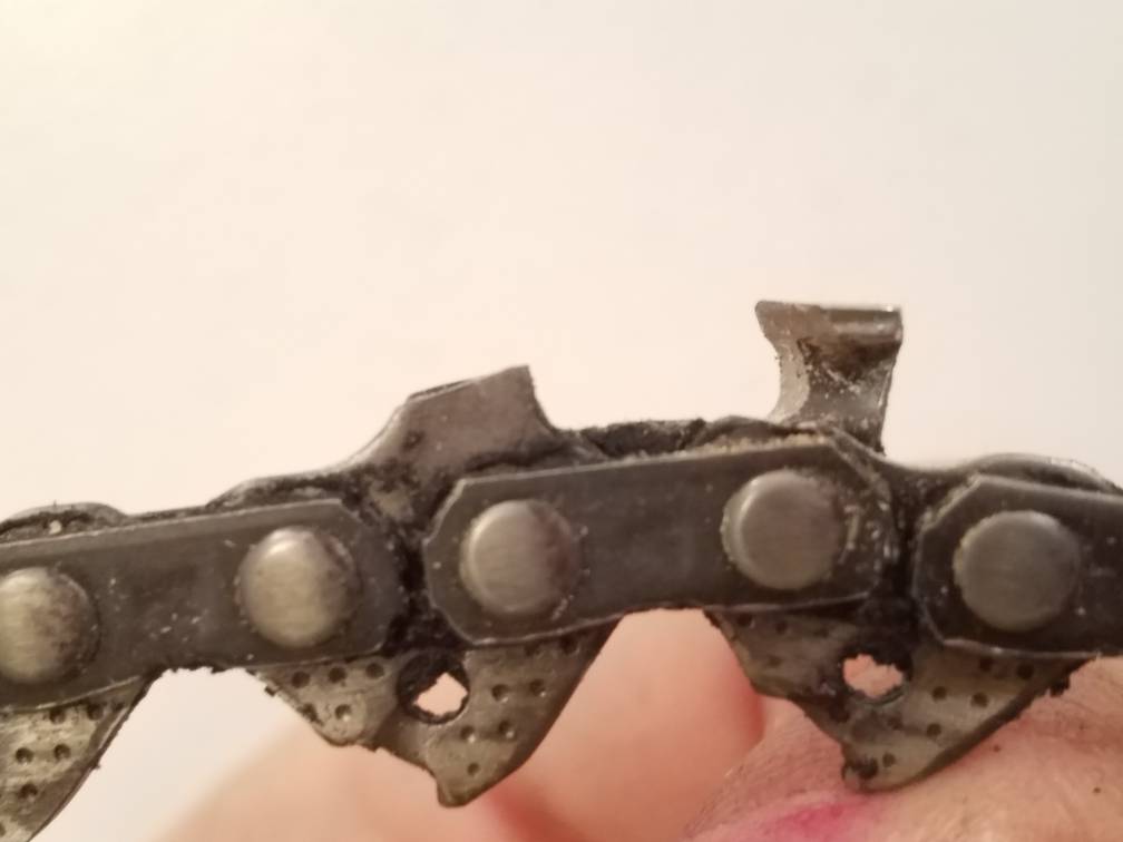

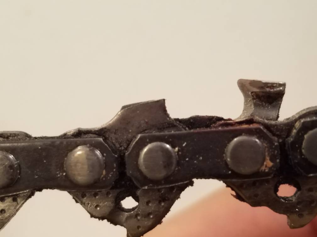

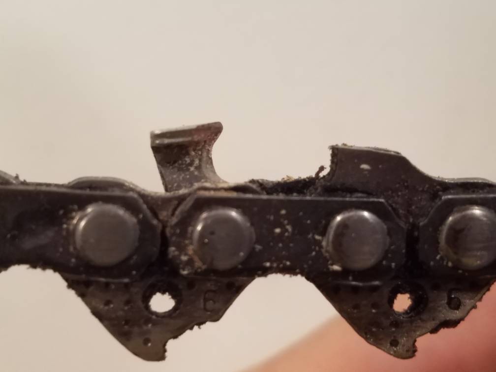

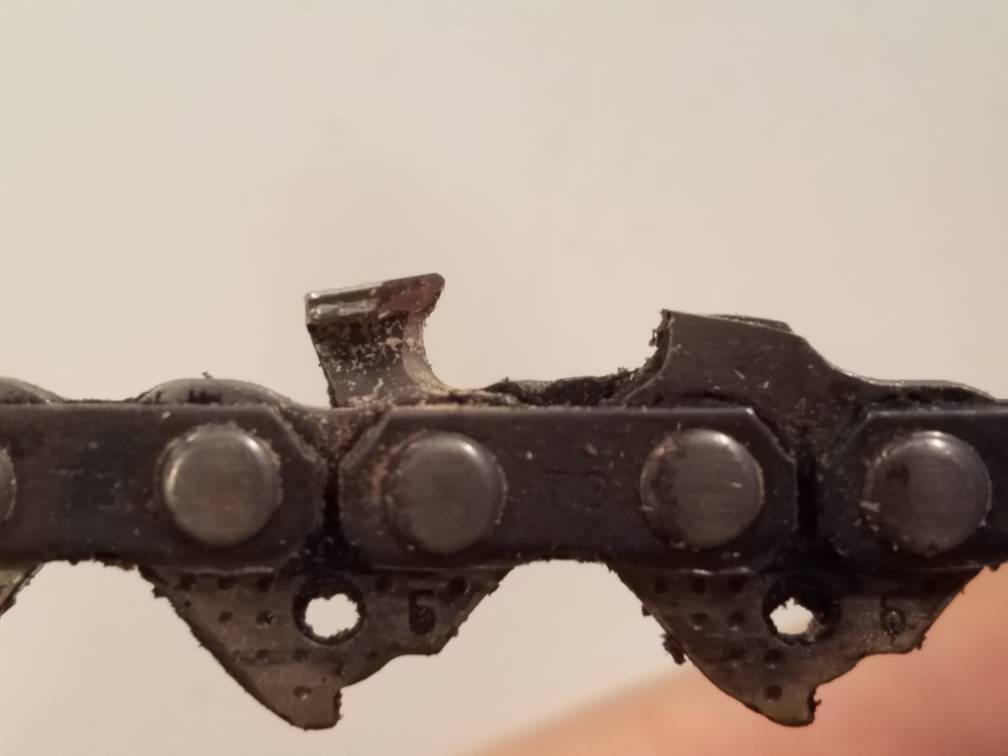

Sorry, it's not actually a diamond wheel. It's from diamondwheelinc.com, but it's their "Super Abrasive CBN" It's the same as (CS575.3878E) on this page except custom ordered in 5/32" thickness.
https://www.diamondwheelinc.com/chain-saw-wheels.html
The pics below show the most hook I could figure out how to get with this wheel and grinder. The wheel angle was 45 degrees (the minimum), and the chain rotation at 35 (max). There's definitely more hook hook than before. (Remember it's RM chain so there won't be a point.)
But it still doesn't self feed well. I have to push slightly. I don't get it. Did I still fail on the hook? Or should I be lowering the rakers now?

Looks like that one was sharpened once at one angle then you ran it again to get more hook in it. Almost looks like the stop wasn’t close enough to the stone. Still have a real shallow angle on top plate looking from the side. And it doesn’t look like that top plate edge got nice and sharp in these photos.

The curve of your teeth in your first photos look very smooth, so it looks like you are grinding smoothly, without burning, but there still seems to be a reflection of light ('glint') off of the top edges. Might be the photo, but light only reflects off of a flat surface, and those top plate edges (and side plate edges) do the actual cutting. Start by checking that out.
Some of the cutters in the last photos look better (no glint), but again, can't always go by the photos.
As for 'self-feeding', you will want to play with adding more 'hook' to the cutters, so that the top plate edges enter into the wood earlier than the side plate edges. Not too much room left in that chain, but try changing the grinder head angle from say 60° to 55° for example.
A lot of guys get distracted by the shape of the gullet, but remember that is the edges (top and side) of each cutter that do the cutting, not the gullets or depth gauges. Focus on those edges, whether you file, or grind, or use vitreous wheels, or CBN wheels. or anything else to achieve that.

Holy crap they have way, way less hook than mine does.
