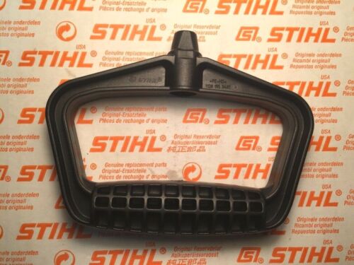

I was surprised by the compression of the 592 cold!
I've got a couple of high compression big cc saws. A "D" handle and timing the piston after tdc is critical for a start. I hate to suggest it but a stihl elasto-start handle has saved my arm a couple of times.
