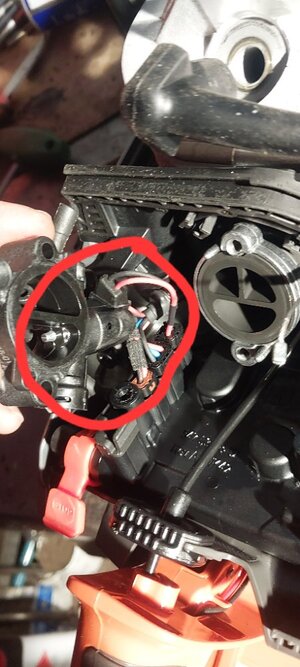

Nice pics! Thanks for posting. But where is the injector?? I'm so curious about that.
Jamie D
Active OPE Member
5:06 PM
35354
Jan 26, 2026
2
7
Australia
There to the left. Then the throttle body mounts onto this again.
