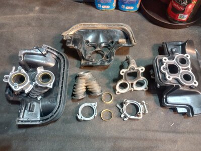

I read here and on the other site that Loctite 401 can be used to repair small cracks in the boot. Anyone ever tried it for a temporary fix?
I wouldn't skimp on a part that costs as little as a boot.
After all, a 592 is an expensive chainsaw to gamble with.
Doesn't sound like a good way to make a person happy. Better to get the new and improved part installed, so as not to have a repeat, IMO.
Yep, I’d agree if the boot was actually cheap. I don’t consider 120 to be anywhere close to cheap for a piece of rubber.

It's the entire intake, fully assembled. Yeah, it's a bit spendy but, so is a new bottom and top end.
Its sort of like stepping over a dollar to pick uo a dime. Trying to save money on something that could potentially causes a seizure or worse is ridiculous IMO.
I agree that it's a lot of money for a boot, Steve says it's a complete boot though.
I look at it in comparison to a top end kit, and to the value of a 592, and then I feel the parts cost of a boot is small compared to the other.
But $120 is actually a lot of money now, compared to prices just a few years ago.
Finally, when I try to build or repair I always try to build to the highest standard I can, and mostly original parts. There is something called retaining value
This is what you get for the money.
