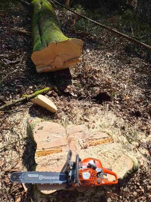

After running my ported 564xp for a week there is not much wrong I can say about it. Ergonomically is in the class of its own. It's way more powerful than 562xp. Efi gives it instant throttle respond and muff modded is not that loud. Comparing it to 400.1 is ridiculous in every espect except build quality.

Sonyour thinking its superior to a 400.1? Care to go into that in detail?

I dont have a 400.1 but I have an Eathan Trainer ported 400! Its pretty dang strong. Not sure if my 564 can keep up. Only one way to find out!

Nice work Sir.
Let us know how you like it long term after break in.

IMHO it is much better saw for daily use. Antivibration system is near perfect. It seats in my hands like a violin. I'm much more precise on stump than I was with 562xp. It has more power than 401 and it starts every time. Something I cannot say for 401. And damn thing vibrates like crazy.
Nevertheless it is build like all 5 series husky. Chinese bearings, gilardoni cylinder that you just look at and it's flaking off. We'll see how long can it takes the beating we are giving it

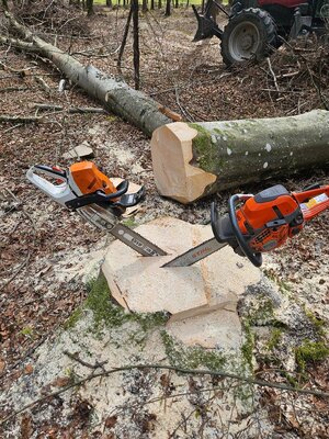

Had some time today and tested cutting speed with same bar and chain. Stihl was actually little faster. But it's a vibrator comparing it to husky. And I did only 2 huskies so far.
