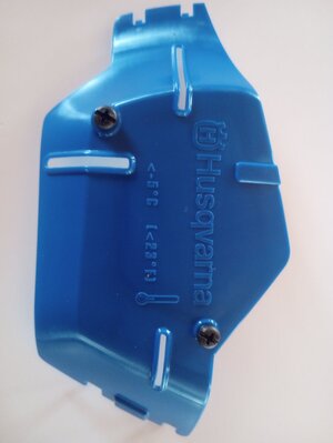

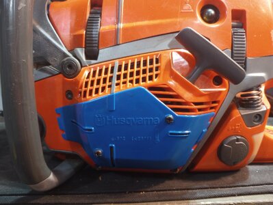

Well folks, seems that this is what is supposed to help these saws along in the cold weather.
The owner stopped as low as to read the owners manual and after doing so had me get one of these on his saw before taking it back out in the woods.
I just minutes ago was told that the new replacement part is updated and needed up for the cold weather.
So, hopefully I don't see this saw again until the muffler finishes what it started. 🤪
I'm guessing the updated intake boot will do more with cold weather longevity than that cover will do. I'd think that is more for carb icing than anything?
I'm sceptical myself, but the owner read the manual, I did not. So, I guess it's a trial, wonder if he'll take it off when it hits 23°F or not. Maybe I should order a new piston and cylinder now. Lol

It's a bit of a stretch why some last while others smoke even at warmer temperatures.
Having it set up for winter operation, with the top cover and the blue winter cover on, helps, quite logically actually.

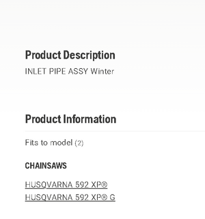

Curious, who told you that?
I wonder what the difference is in the updated "normal" part vs the winter one?
Here's the winter one.
One would think the winter one would be even better yet at handling colder temps.
A little birdie with a new 592xp that took it back to the dealership it was attained at for warranty.
I dunno, I'm still trying to figure out where in the sky to pull updated part numbers out of so as to be able to order them.
One would. I guess it would pay off to purchase a "G" model for winter work even if uninterested in the heated handles.
I know. What I do is go directly to Husqvarna's website to get a part number for the model I'm looking at parts for, then I Google that part number. That Husqvparts site seems to always be near the top and it always seems to be correct if they state there is a superseded part to the one that I Googled.
I just got off the phone with a dealer near me and he confirmed two things, one the new part number is the latest, which we knew and the "winter" version is on back order till May and it does also fit the standard non-G model. So that one may be hard to get if one wants one.
