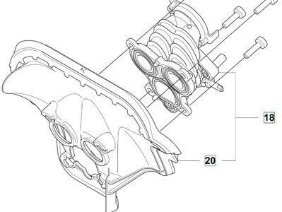

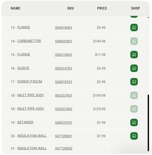

All I know is this is what Husqvarna's parts order website says, numbers 18 and 19 are the two intakes.

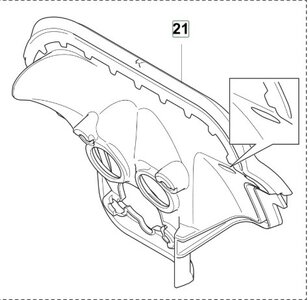

One thing I surely don't understand is why on planet Pluton is the partition wall offered as a part to purchase, when there is no way to install it? The intake boot has it trapped. Or... am I missing something?
Doesn’t the rubber come off the metal plate on the cylinder side?

It's molded all one piece, and all three openings are joined together at that point.
I’m baffled. So it doesn’t come loose from the metal? Or are you saying it is molded together on the back side of the metal between the metal and the partition? That’s weird.
No it doesn’t come out of the metal flange with out destroying it, at least mine didn’t. I don’t know why it has to come with partition wall ether, that part does blow and makes cost more too I’m sure.

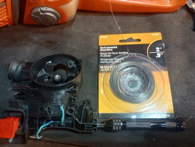

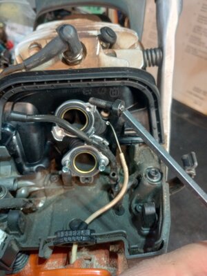

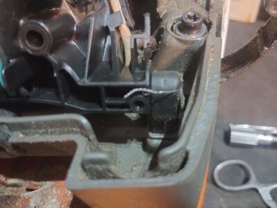

Well, as far as whether or not it will come apart, everyone was right and everyone was wrong. It will come half way apart as you can see in the pic. The boot to the carburetor is attached permanently, the strato boot will come off. I dug around on the old junk one to not be concerned about causing damage to the new.
Speaking of these are the same ones as the old , best I can figure.
