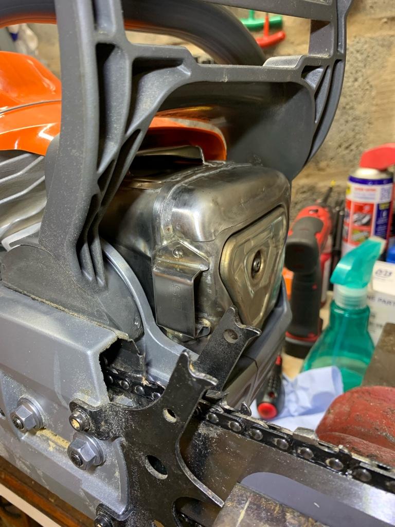

View attachment 340424 View attachment 340423 View attachment 340422 592xp had for almost 4 months now no issues, ergonomics are very good , power and acceleration top notch View attachment 340421 it’s not a torque monster , but it will get the job done in a hurry, very happy with its performance so far running a 28” bar seems like a perfect balance for it , did a muffler mod on it from WCS power port made some gain on the top end and runs cooler ,

I liked your idea on the muffler so I did the same. I had used rivnuts but they didn’t hold so ended up brazing it on. Nice sound off it.
Finished porting it so will get some testing done.
Nice work :thumbsup:
