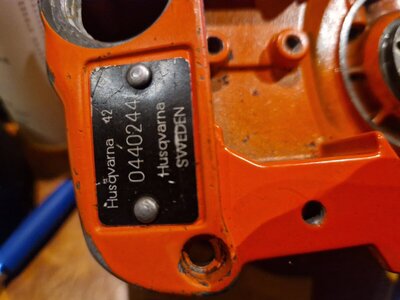

Mine doesn't have special on the top cover but special on the recoil. So I guess my question is, how do you know you have a special and not a recoil with a badge on it?

I don't think there was a difference except that the orange top cover had a special decal, while the gray top cover had 42 printed.
The decal on the starter cover was also different, the one for the orange top cover was silver while the one for the gray top cover was gray.
Later, there was a starter cover with 42 special, around 1992 and newer.
But, I've never had a 42 special from that era myself, ie, older then 1992.
Mines a 92 with starter cover decal. But to my question, how can you tell that it's a Special? The jug? It's just like if you had a 261 without the tag and put a 262 starter cover on it. You would have no way of knowing just looking at it.
