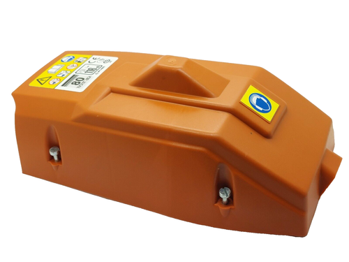

That's the 357/359 bearings that are made in Japan.
The top covers are the same ones I posted earlier, from the same UK based seller.
