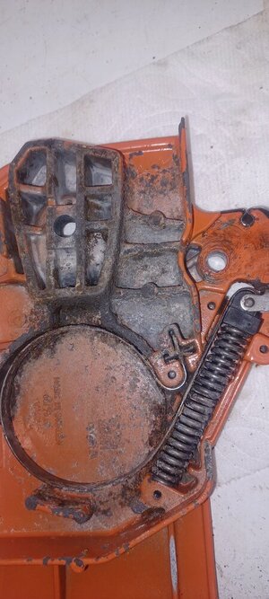

Thanks i am a new member on this forum mye latest builds hq 254 xpg, 162 sg 42 special and now 42 special trying freshing up old sylinder and piston.

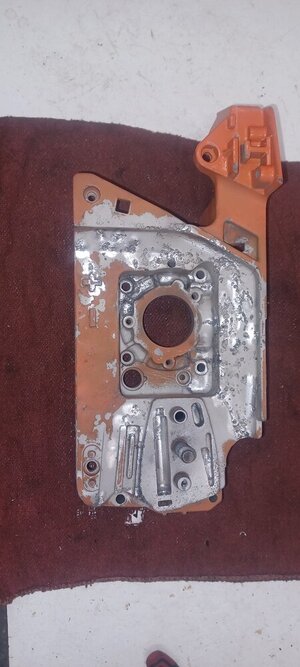

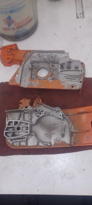

Case mag rot repaired can i ask what you have done with it have you paint cod or a color that match.

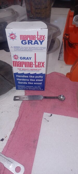

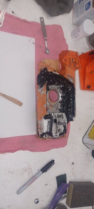

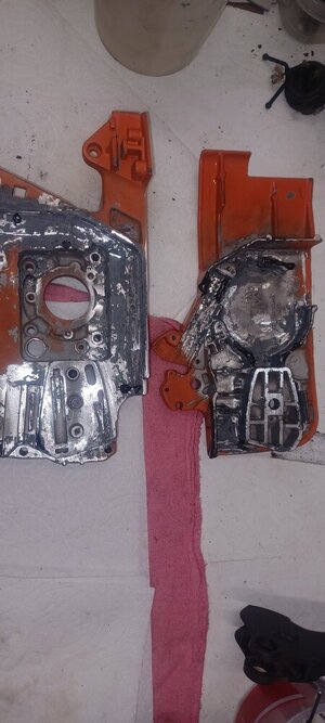

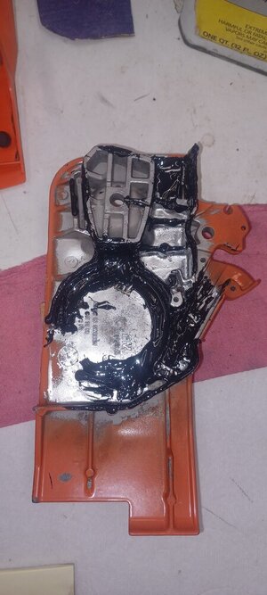

Bead blasted all, or as much as I could, of the oxidation to clean metal. Acetone to get any final stuff. Marine-tech epoxy, heated slightly, into the voids after heating the case half. Heat gun, again but not too hot, to get the epoxy to flow into small spots and smooth ever out with a small sculpting knife.
Cure.
Re-sculpt with burr and sanding bits back to shape. Hand sand with 120g. Yea, it takes quite some time if extensive damage.

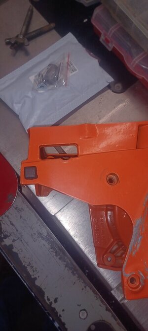

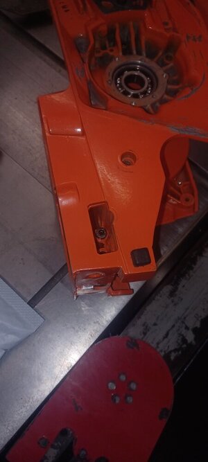

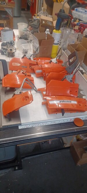

The Husqvarna paint seems to match very well unless the old paint is too faded.20251012_181735.jpg2100 case, welded, reshaped, painted20251012_181812.jpg20251012_181824.jpg

Painted
They aren't perfect but will function.
To get a more even and 'like new' appearance, more detailed sanding would be needed, especially in blending into existing paint. Ideally, the entire piece could be bead blasted but i was interested in that much work, :p i just wanted a functioning saw.

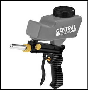

Bead blasting is the same as sand blasting, using an air compressor to shoot sand (or beads, crushed walnut shells...among other abrasives)

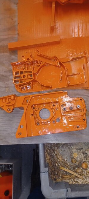

I don't have one of these setups, but I use a Dremel with a wire wheel to clean the area and the mag rot, then I fill it with JB Weld. After it dries, sand it, prime it and then paint it.
A sand/bead blasting setup will speed up the process and probably do a more effective/efficient job at it.
I use a dremel and fine wire brush to get spots the blast doesnt.
Is the jb weld hard to sand, dremel or hand sending ?
No, it works easily. Easy to sculpt :thumbsup:
Yeah, its easy to work with, you mix the compound and hardener (black and white), when it is a dark gray, it is ready to go. Spread it on as needed, you can use a heat gun to warm it up so it smooths out some. I give it about 24 hours to dry/cure and then sand it with a Dremel or sand paper until it is where I want it. If I go a little too much then I mix up some more JB Weld and reapply. So far it has worked well with primer and paint on it. It ends up being quite tough.
I have a couple of McCulloch saws which have pretty bad rot and what I have done so far has worked well. Here is a link to some pictures I posted with the parts cleaned up and then after the JB Weld and primer has gone on. There are still some minor imperfections, but some of those are hard to see until you have primer or paint on them.
