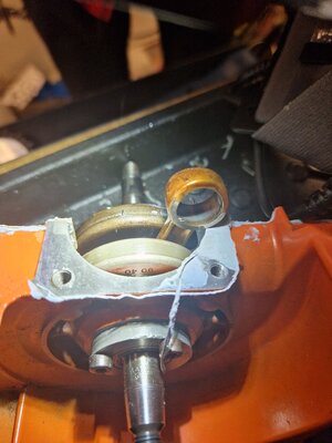

How did you find out it had a leak between the bearing and the crankshaft? Did you do this with the oil seal off when you pressure tested? If you did the test with the oil seal on and it is leaking along the crankshaft, then you will need a new oil seal, one with a softer rubber and newer spring in it to hold it against the crankshaft to prevent the leaking. You should not need to replace the bearing unless it is corroded, burned, loose or broken.
This leak is not related to the oil seal, but between the bearing and the crankshaft.
Harald H
Active OPE Member
12:49 PM
33039
May 21, 2025
13
22
Norway
You have to split the crankcase again anyway with that leak.
It's 50-50 if it's an oversized bearing, or if the crankshaft is undersized, you can find out by testing a 6201 bearing on the shaft, if the bearing slides in without having to press, you can throw the crank.
I've seen this a few times, on both 238 and 242, twice on both 238 and 242, undersized crankshaft.
Ok, thank you. More work on this 42 than I planned.
It's very disappointing when things like this come up on the pressure test, I've been there four times myself, I know how it feels.
A couple of them were very surprising too.
I had a five-year break from chainsaws, but this spring I got hold of four 238 projects where all the cranks were good, and three 242 04 cranks, so suddenly all the waiting projects were in order.
When you split the crankcase, that is, you actually only need to split the chain side, you can try to see if the 6201 bearing slides too easily into the crankshaft.
Try a couple of bearings.
If they fit snugly as usual, the bearing is faulty.

Hi, thank you for the details. I did split it some weeks ago. Originally I meant to replace both bearings, when I found out that pto bearing is not so easy to find etc. Then I decided to keep the original on the pto side, and replaced the flywheel bearing with a new. I guess it might very well be that the original bearing is the source of the problem and I can order a new one from skogsverktyg.se, but we will find out. I live in Oslo :D

I would split the crankcase and check if it is the crank that is at fault. You will have to split the crankcase anyway if it is the crank or the bearing that is the culprit.
And, you should look on the flywheel side for the serial number your crank has, you may be able to see it without having to take the crank out, but it is etched with a number.
Then we must take the steps according to what you find out.

It seems like the crankshaft is ok and the bearing is not. I don't know if it matters much know, but the crankshaft number I see is 90 40.
Tor R
Novice, Leg model #2
12:49 PM
439
Jan 8, 2016
6,865
45,958
Mandal
Better that the bearing is undersized than that the crank is, good news Harald.
Yep, there you have the week and year the crank was manufactured, right below is the part number the crank had, then rotate the crank a little and you can possibly spot parts of the number.
What you will see is that the number ends in 01 or 02 (since your saw is so old that the 03 and 04 cranks had not arrived).
I’ll check SB tomorrow for you.
