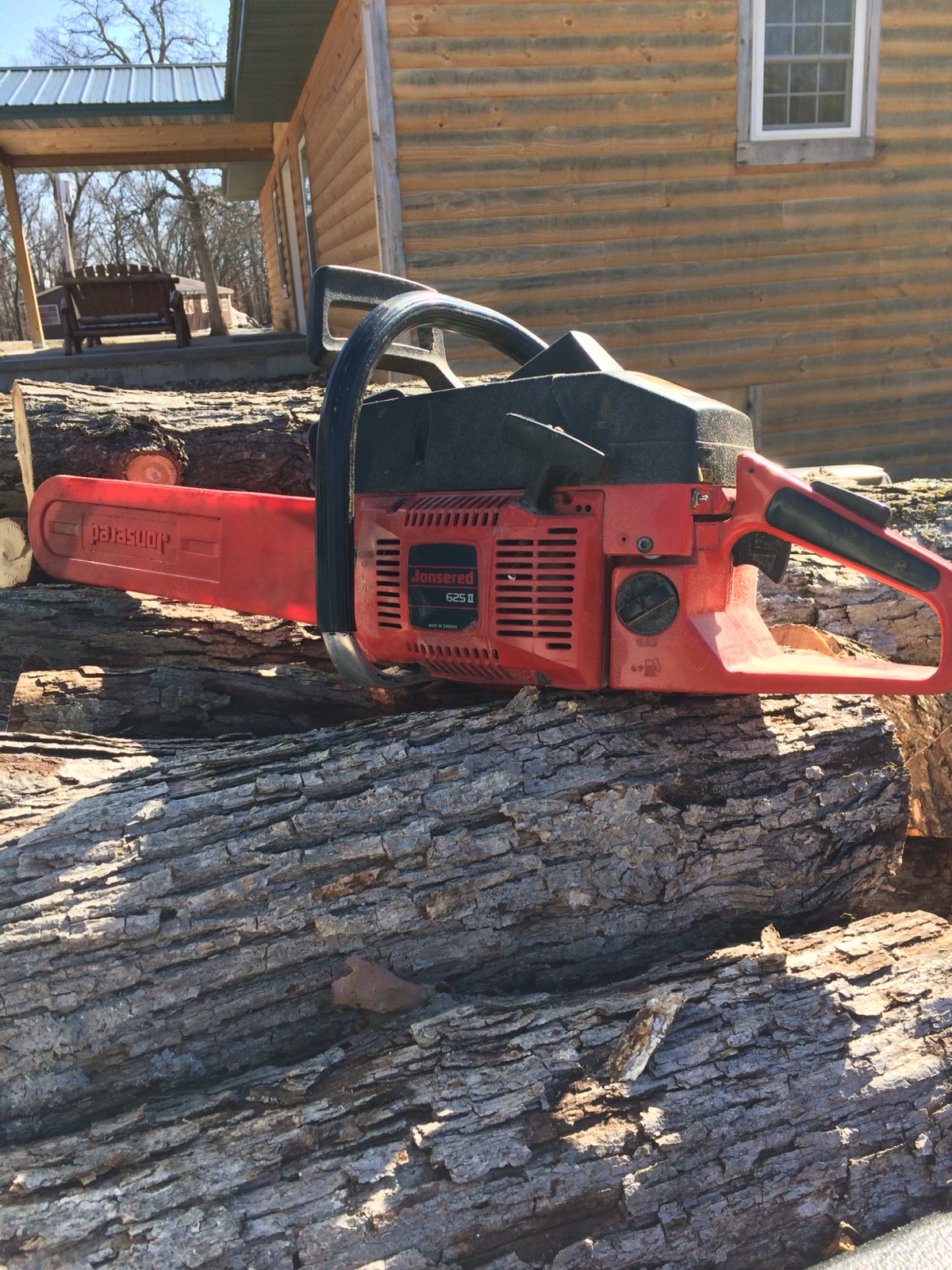

Can the 625 be talked about in here? I have a cherry 625 I picked up and a mofo 272 topend that need to go together - man I am terrible about finishing things.
Of course; any model ever made on the chassis. They'd never all fit in the thread title. :)
