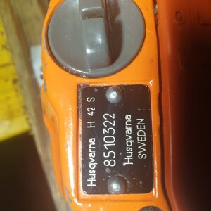

Well I only have a H 42 S, it is my opinion that it was the anniversary model that had the S. Cylinder wise there was no difference from the 42S to the 42 from 1990 at least not on the 42S I have
