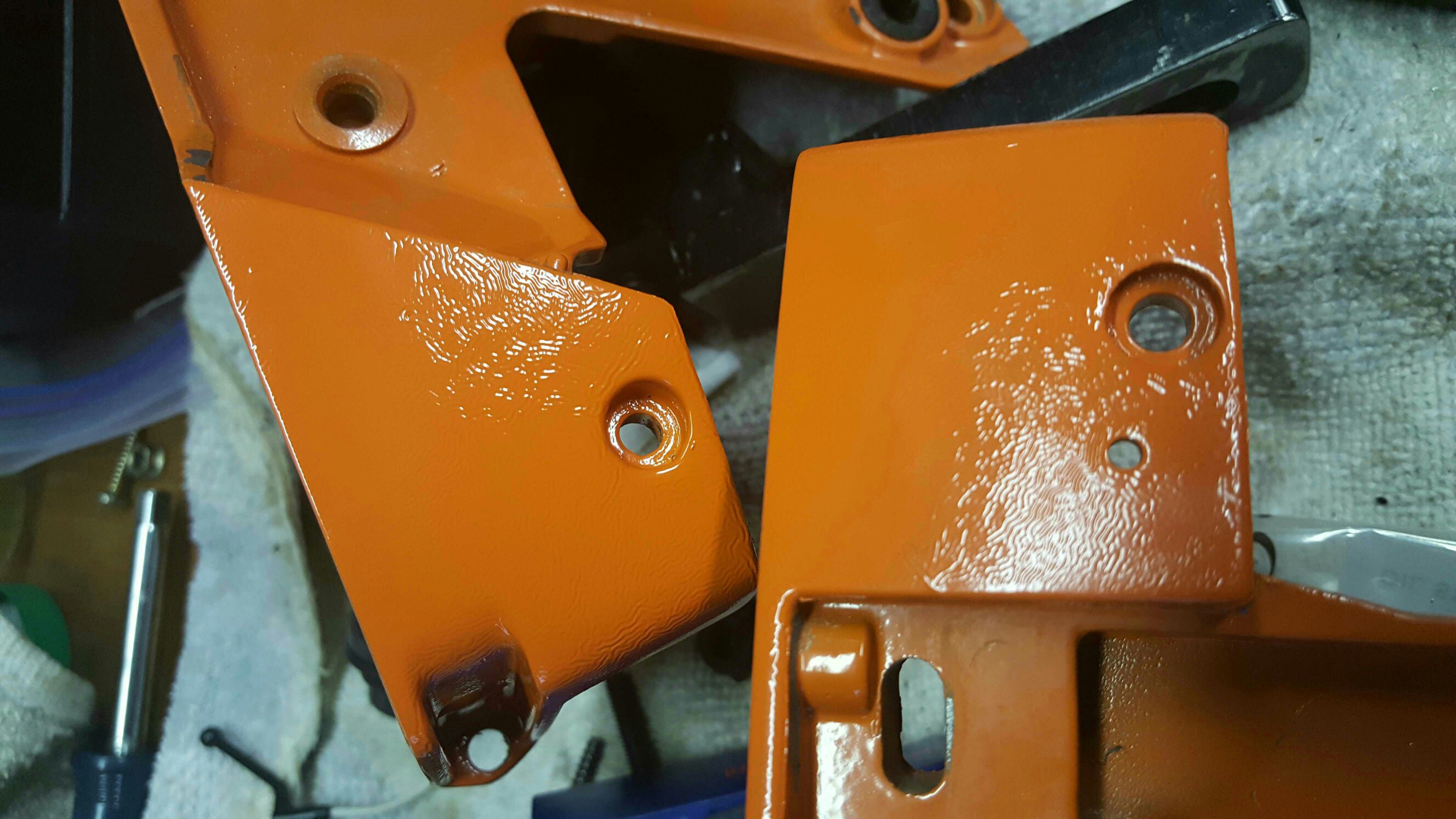

Well when I said I wanted to do the whole saw I was only half serious. Then I threw a couple logs in the woodburner and opened the vent. Now I'll sandblast the wrinkled paint off along with the rest of the case halves and either paint or powder coat it!

Welcome to the club. That's from using slow-ass drying oil based paint combined with inconsistent temps, like us northerners and our wood stoves. By the time I figured out what was causing it, I had already sprayed and refinished my 066 and 044 cases 3 times. I was so pissed

Ross's summer time paint method.
What for a hot sunny week. First coat, hang out in sun. Disappear to work for a couple days. Second coat,repeat step one. Third coat repeat step one. Be amazed how good bits n pieces turn out.

Pretty sure that 24 hr recommended dry time takes more than a half hour on the wood stove. I'm using Drf's method from now on. PPG in Ford Lt. Grey and a small brush
