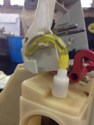

Oh, forgot to add
My tank breather wouldn't breath, so I made another by pushing the grub screws in in stead of screwing them in.
I put a bit of WD-40 down the line first to help them slide in
Works a treat now!

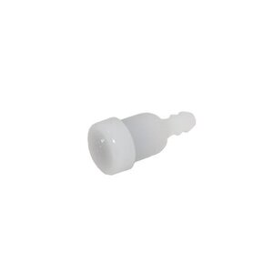

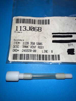

Brews, and anyone who sees this pic and knows these saws, I am curious about the breather hose and grub screws. Is there a spring between the screw and the plastic nipple? Also, I have seen this part look a bit differently too.
VS. See how this version has a plastic end on the far end and apparently a spring with no grub screws in between.
My 044 snapped the tube off and this was the first I saw the grub screw style.

A simple tank vent from Echo can be utilized successfully in leu of the grub screws with the addition of just a tad bit longer fuel line to allow it to hang upside down in the area made for it.
https://www.hlsproparts.com/product-p/a356000031.htm
Thanks Stump Shot. I can see how one could do that, but I am new to the 044 and Stihl's various tank vents. I understand the basics of the grub screws in the tubing design, but I was curious because of seeing at least 2 type with the snorkel nipple style vented hoses with or without grub screw like in the 2nd pic I posted above.
I had to replace the vent tube on my 066 (original melted in a fire), ended up ordering 6 grub screws and inserted two in the vent tube (4 for the stock pile). They work great without any spring, but I think you have several options to choose from - unless you are trying to get your saw to look like it just rolled off the factory showroom floor :D
I am guessing the spring is mostly to help keep the vent line from collapsing or pinching in a bend - giving some rigidity to the line.
In my case, I was disassembling my handle/ air box/ throttle linkage to remove the carb, when the saw fell off my dirtbike seat I had set it on. It landed on the wooden ramp at the back of my trailer and the vent tube snapped off. When I picked up the tube and saw, I saw that it was not just an unobstructed tube, but had the 2 grub screws. IF it had a spring in the tubing it flew away and there is no way to have known if it ever had one until I came and found this thread. It makes sense now. Much like springs inside radiator hoses. I can see some easy way of replacing a spring if I really run into the tubing collapsing issue. One could likely rob one off a ball point pen. I will cut out the old grub screws and fab up a vent using the proper sized ID tubing from some of the fuel line that I have on hand.
Now I am waiting for my OEM Stihl ZAMA carb rebuild kits to arrive. Part number 0000 007 1080 for my Zama C3M S5E carb

The spring is to prevent the tube kinking, the vent on the 025 is shorter and lacking the arched support. I used ECHO Black fuel line with Stumps' check valve remedy. The Oregon tube was always falling off from vibration, the ECHO seems to be the answer, Thicker wall and more elastic might prevent the kinky issue.

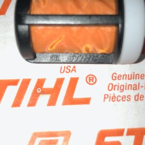

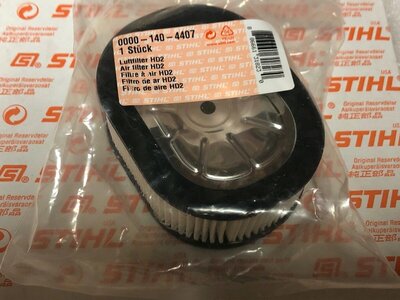

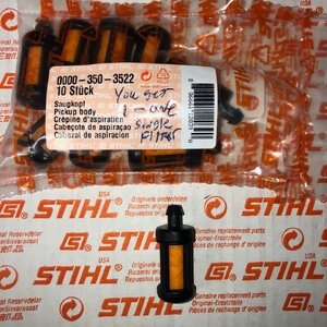

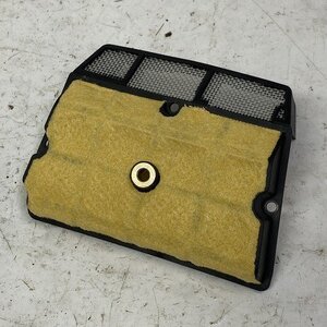

Ok guys, As I am new to owning a used 044 and 201T and even a 193T I have some questions for doing some maintenance to them.
As I was pulling all my saws out of storage to look them over and fire them up, I noticed that the 201T was missing the fuel filter. The 044 I have is the Flock Air Filter style similar to my 026. So, the questions I have are these. If I get a supply of 6 or 12 Fuel Filters for the part number the 044 calls for, just how different are they than the one for the 201T and couldn't I just use the 044 ones for the 201 even if they are different part numbers? HOW critical is this? Next, I know that some 044's can use the automotive style air filter. Am I best to just get the same type OEM stock filter my saw came with, or if I'd get significantly better filtration, is it worth making the mods to the saw and switch over to the automotive style filters?

I started with the HD2 on my 044 and it never sealed completely, fine sawdust was getting under. Tried a Max Flow and another oiled foam on plastic cage type similar to Maxflow (Redbeard maybe) and went with it so I can get the factory cover on. Never saw any fine dust getting under the Max Flow or Redbeard. Make you a heckuva deal on a barely used Max Flow setup. 2 filters, cage and cover. Give you this HD2 for cost of shipping.
