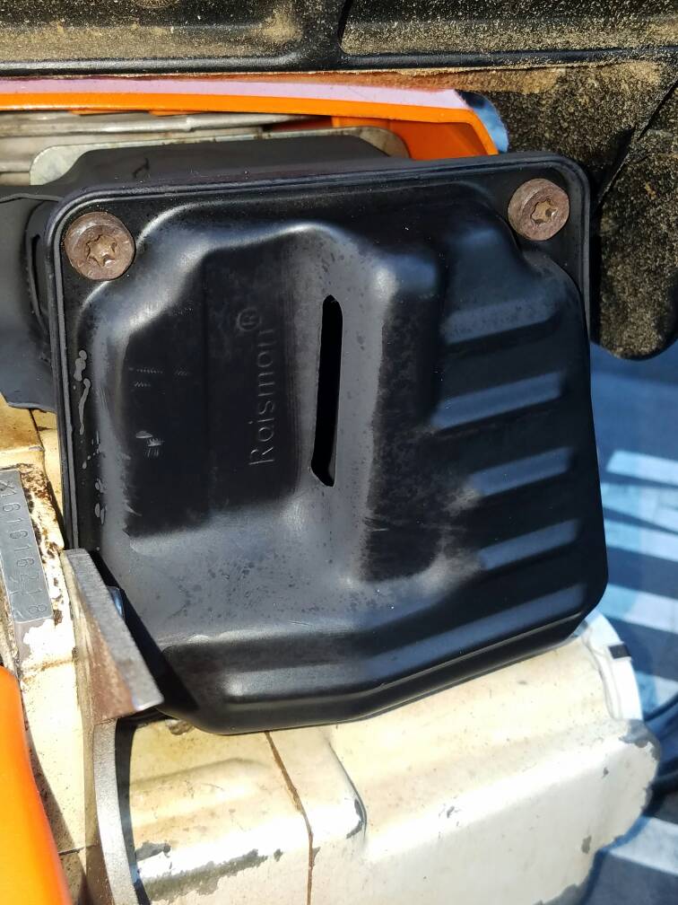

Sounds good and appears to run much better Eric!

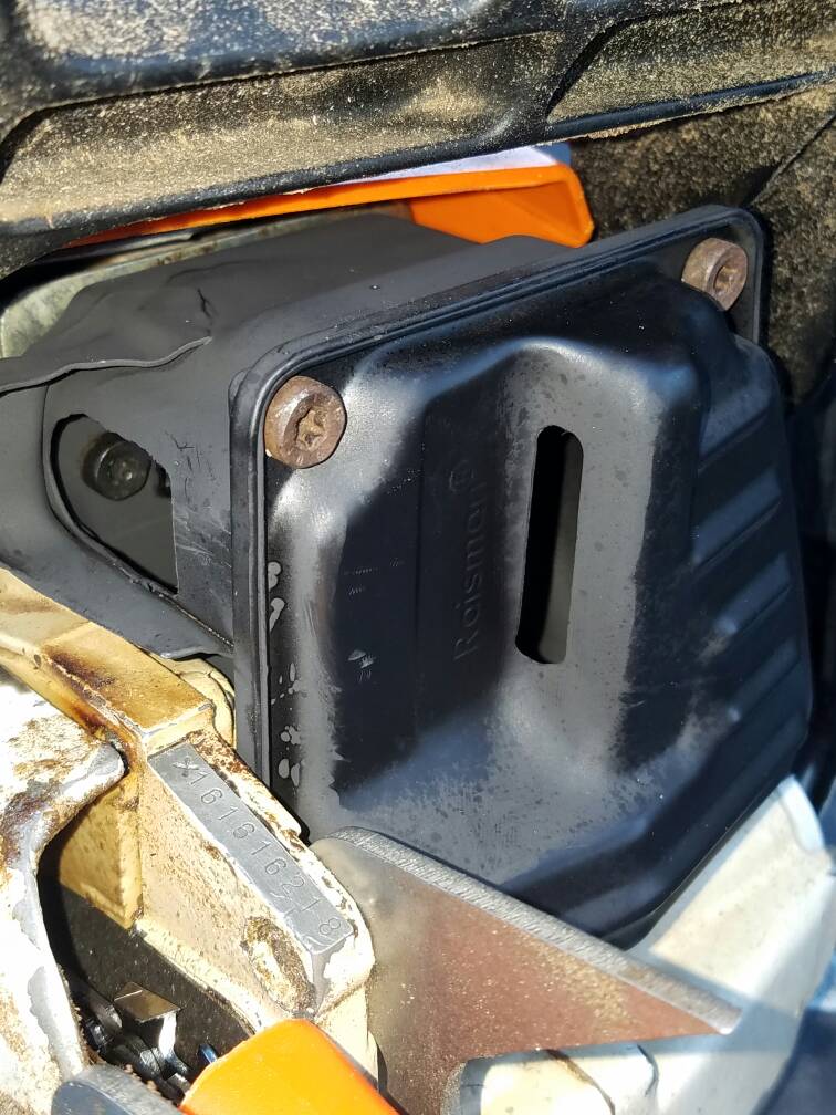

Here is a photo of my dual port muffler that I just got. It is a Raisman brand. I opened it up a little more.

Sounds much better Eric.
What filter do you have on it?
A little timing advance, a base gasket delete ... maybe after I let you run 044#1 again!

Just need to get it ported to really wake it up! Take full advantage of the DP muffler. Lol
It is still stock hd filter. Owner at budget with other parts. I'll see if he wants to spend $40 or whatever for the HD2 and then tune it again.
