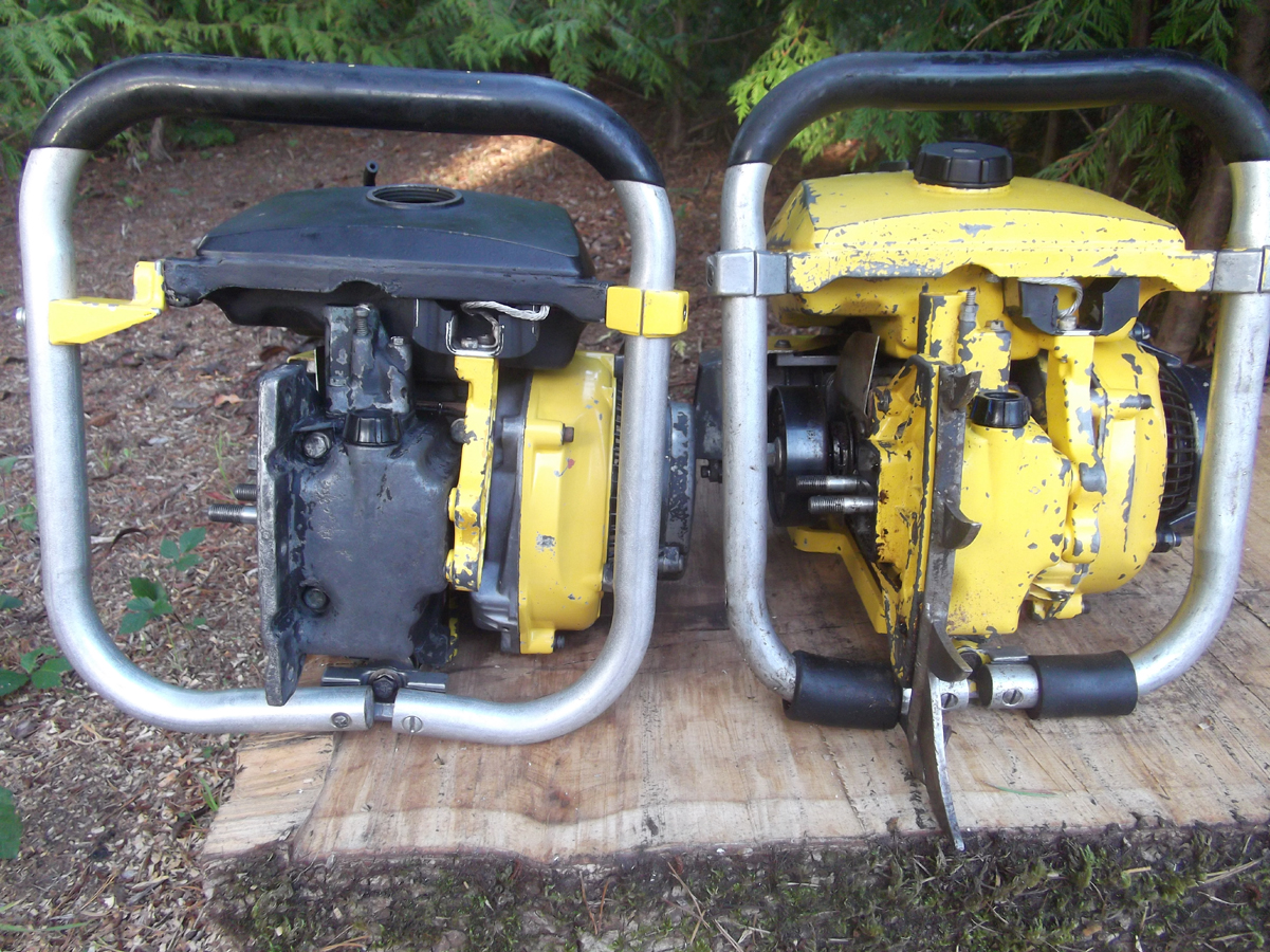

One final detail - on the left is the big bore saw and on the right is the standard SP I built earlier in the thread. The big bore saw has the wide handlebar that was designed
for the later saws that came with a chain brake. It uses an extension bracket to mount to the tank. Guys that have milled with 125s like the wider handlebar a lot more, as
it provides more room for accessing the clutch cover. I knew a guy that was using 125s to build a log cabin in BC years ago and he would run the wide handle with a cut-down
clutch cover. He wore out three saws by the time his cabin was done.
That’s cool, I have a wide wrap, but no bracket! I have wanted to try a modified cover on the sp, the cover doesn’t clear chips well I have thought about modifying a 250-300 cover, because they are cheap, I haven’t fit one on a 125 though, but have seen some guys run them, the back line is too vertical and too close to the clutch, I think it hurts in long bar use
I think people mod the 250-300 covers a lot when running them on the 125s - I've seen quite a few.
I got a bracket for you for your wide handle. I think I have three extras.

Also all the SP105's got the thinner side covers. All the sp125's I have had and seen all
had the wide covers. CP's had the thin ones like bigmac stated. The SP's with wide cover
also had a longer starter drive.
I like the early original logo way better than the new one.
