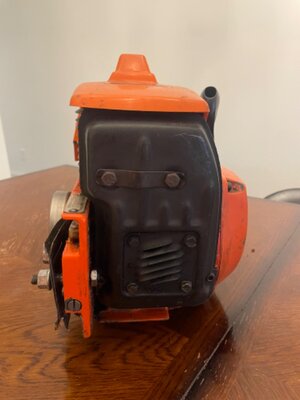

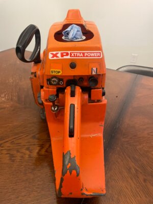

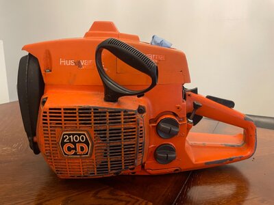

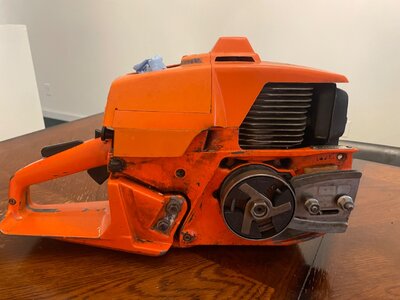

Good morning fellas. Since it seemed like folks appreciated me posting a build thread recently, I figured I would do it again while I work my way through this Husky 2100CD. I have never run one of these before, or worked on one. Here is the saw as I removed it from the box. Yes, the handle, clutch cover, and air filter came with it.IMG_8239.jpegIMG_8240.jpegIMG_8241.jpegIMG_8242.jpeg
