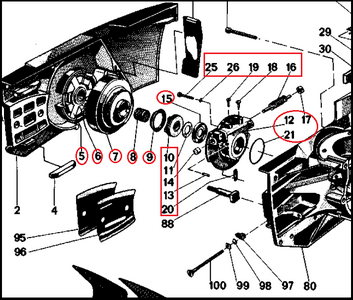

I haven't a clue if I got all the necessary chingaderas between the clutch and oil pump or not.

I think #15 is the oil seal. My #9 ended up being in two pieces (nylon I think), but I used it anyways...lol
I believe there was one called a dust seal or something that I didn't have room for, another one in there that's pretty mangled.
Seems to work.
