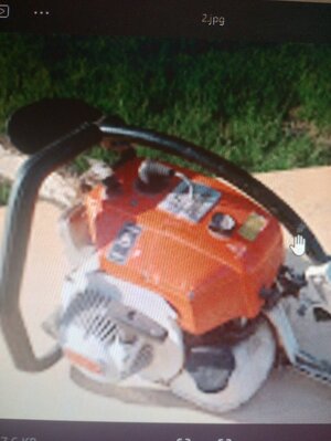

Pics or it doesn’t happen

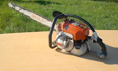

Hello Larry,
I hope all is well in your area. I will try to get a better picture of the handguard but it is not perfect at all. The orange bar is a real nice find as I am not sure how long those were out. There is a huge backstory on this saw and some of it can no longer be confirmed nor denied as folks involved are with the Lord now.
