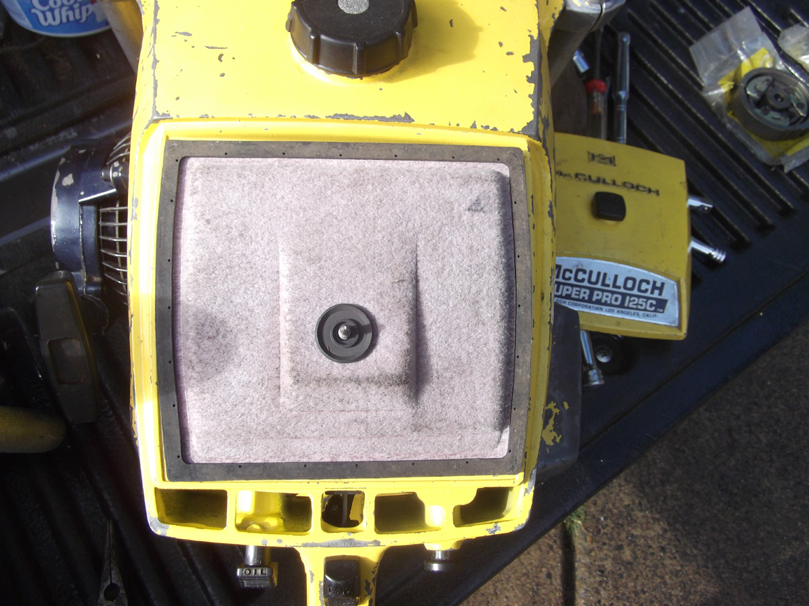

I wanted to show you guys some differences between the starter shrouds. I think the later style is on the left and it has cast-in threaded bosses so you don't have to mess with
epoxying in retainer nuts. They're also a different "thickness." I think there was a post about the early saws not having enough air circulating around the engine so the shrouds
were changed along with re-designing the cylinder so that it has more and thinner cooling fins.
Good tec there.

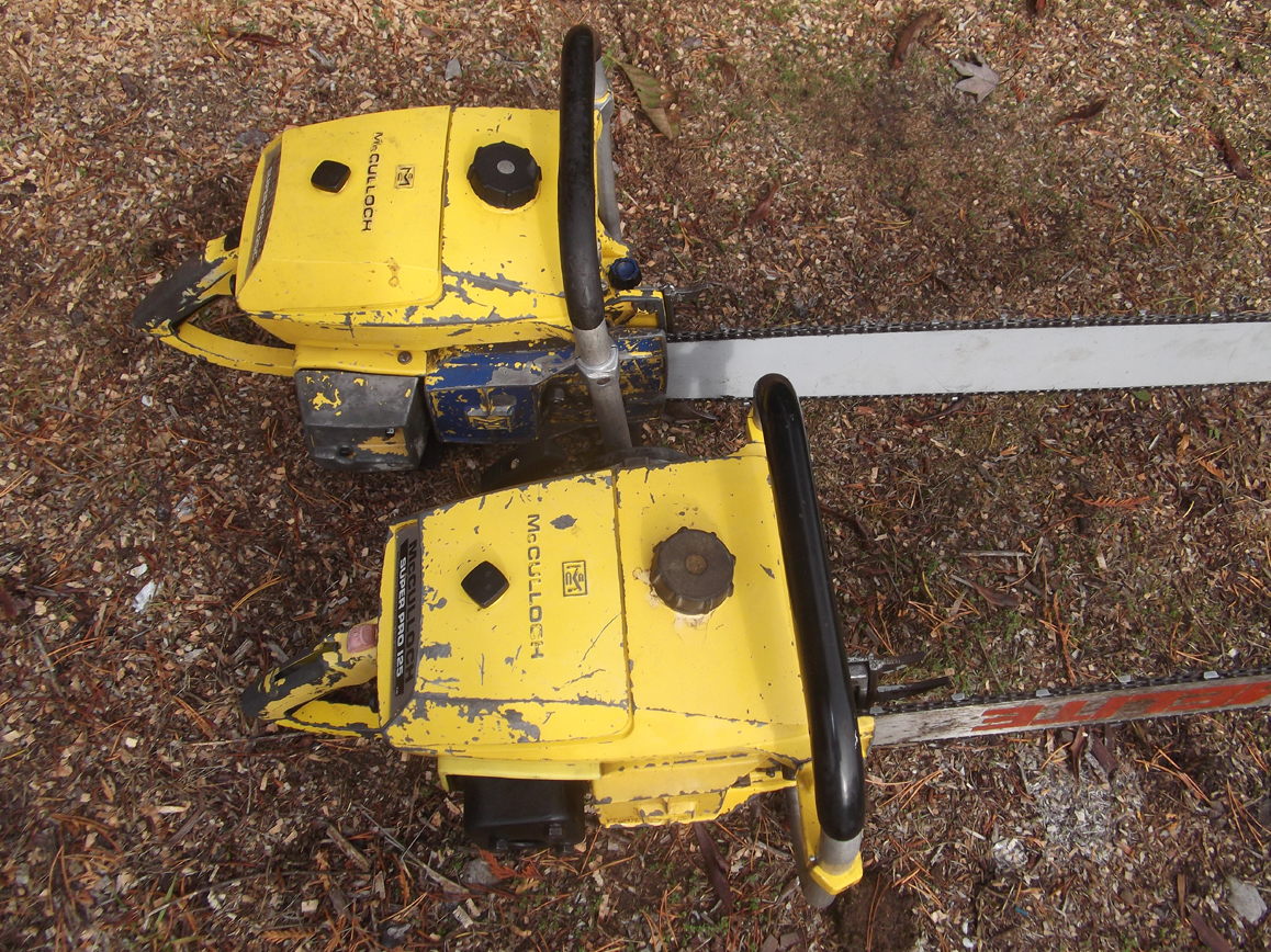

One final detail - on the left is the big bore saw and on the right is the standard SP I built earlier in the thread. The big bore saw has the wide handlebar that was designed
for the later saws that came with a chain brake. It uses an extension bracket to mount to the tank. Guys that have milled with 125s like the wider handlebar a lot more, as
it provides more room for accessing the clutch cover. I knew a guy that was using 125s to build a log cabin in BC years ago and he would run the wide handle with a cut-down
clutch cover. He wore out three saws by the time his cabin was done.
