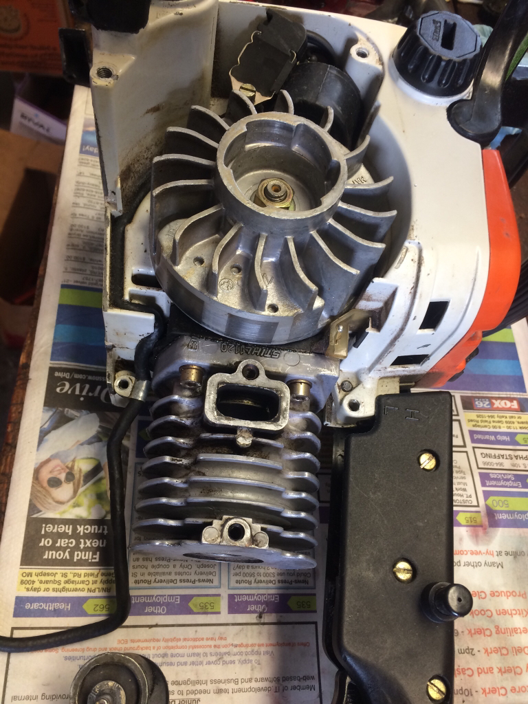

First time putting the rod bearing rollers back in a Stihl 011/012 type.
Visited my local dealer guru and he said to use a strip of paper.
I went one better and used a 1/4" wide rubber band.
Worked good for the vision impaired shaky geezer.
