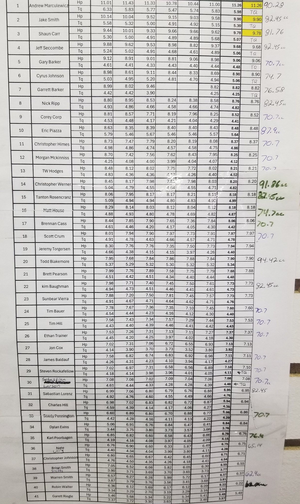

Dyno Results are in!
The third Prototype saw came in 20th out of the 41 saws. Some great info and interesting to see where it baselined against the other saws on the dyno.
Prototype #3 has a 390 crank, and mostly 'stock' big bore 390 top end. (e.g. lower transfers matched to the case, jb weld on the intake) I think it seems to have held pretty consistant numbers across the board during the pulls. Will be interesting to see the offical recap of the event and hear about the top runners.
- Hand written row on the right is the displacement in CC
- Second Furthest row on the right side is the best 3 run avg hp.
- Third Row from the right: The peak Torque is just below the peak Horsepower and 1 box to the left.
Here's the numbers from the pulls above:
Pull 1Pull 2Pull 3Pull 4Pull 5Pull 6Best 3 Average
Horse power7.957.687.847.867.887.847.90 HP
Torque5.375.295.325.305.325.325.34 TQ

Very interesting! Looks like the winner was a 38mm stroke. Over 11 horses in a 372!
Edit: Not sure how anyone squeezed a 38mm crank in a 372, but 38mm stroke x 55mm bore = 90.28cc.
Mine was actually a 38.5mm stroke, 52mm bore = 81.76cc.
I *think?* this might have been the winner (at least based on his FB post/username + winner's name)
An Drew said:
https://www.facebook.com/groups/1194411648235200/user/629261577/
My dynojoe build off saw. Short stroked 3120 in a neotec 372 case.
60mm bore, 41mm stroke. 116cc.
-372 crank, one off 90mm rod from 1984/1985 Yamaha yz80 machined for 20mm big end pin and narrowed on the width and OD of the big end.
-3120 piston and cylinder with big fingers. Primarily bottom fed, stuffed case to match. Spicy numbers, reasonably low compression for heat soak reasons. Trimmed a little bit of the top fins to fit cover. Av mount bolted/expoxied on.
-Tillotson hl-360/380 hybrid carb. External pulse. Wg choke shaft added. Bigger choke plate (hl throttle plate maybe, I don’t remember) soldered in, no screw, thin shaft etc. Throttle shaft is already super thinned from the factory.
-3 x-torq covers chopped up and plastic welded together to make the top cover. Taller grab handle to fit the tall covers.
Nice, congrats on 3rd place & 9.78 HP! Would love to hear more about your build (if you posted it, I'm sorry totally missed it)

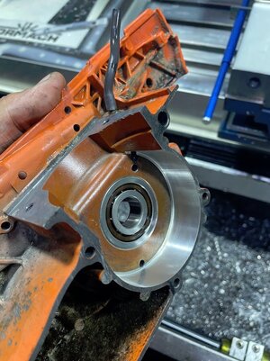

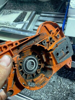

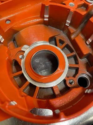

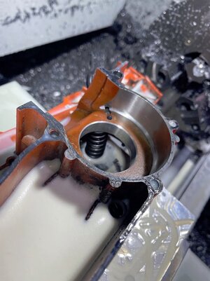

Finally got into the queue for the CNC!!!
Testing in progress, bearing looks like it fits good he's going to do some more machine work on the case half to dial in the crank placement but we're making progress!
Aftermarket 372 case (for reference of where things sit)
The next steps after he gets things test fit, I'm ordering a few parts and sending the 1st prototype down to him to get torn down, have the bottom end machined out / rebuilt and with a 390 crank, bearings, seals and 390 piston and we'll if it will run as hoped.
