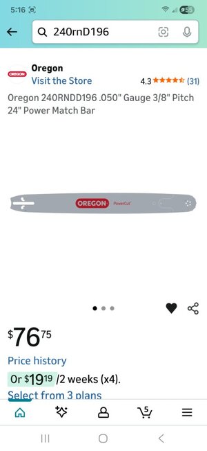

D196 mount in OregonQuestion :
Has anyone tried a later model aftermarket bar & chain combo on one of these ?
The bar is an original Homelite OE but all the stampings are worn off .
It is also a hard tip and I'd rather see a more modern sprocket tipped bar on here .
I gust Googled that and they are only showing a 20" barD196 mount in Oregon
Don’t forget get they make bar stud shims, a simple drill bit will align the oil port. It’s cutting wood, not landing on the moon.I gust Googled that and they are only showing a 20" bar.
I doubt this little 35cc engine is going to handle ^^^ that suckerView attachment 479758
24" amazon
