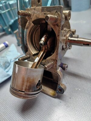

Does anyone have any tricks to install the 28 tiny rollers in the lower connecting rod ?
My plan was to put a coating of synthetic grease on the rod & cap , install the rollers and let them sit in the freezer overnight .
Then (hopefully) install the rod & cap before the grease loosens up .

That is pretty much how you can do it, not sure if you need to put it in the freezer, they should hold in place with the grease. Yeah, that was a big surprise when I pulled my first McCulloch crank rod apart... 🤣
I am not sure if the Homelite crank rods are in a similar situation like the McCulloch crank rods, where the two halves only go back together one way as they are hydraulically split and not cut so the two sides are not identically flat or even.

I don't know if they're "cracked" or not either , but I marked everything with a white paint pen .
