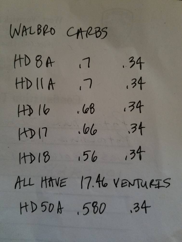

Just some info that I put together from talking to Walbro tech.
Jet sizes for 044/046 carbs.
