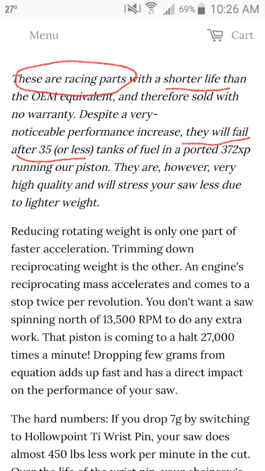

Don't you think that work saws should be fun to?
Fun>Reciprocally enhanced
I agree, all saws are supposed to be fun to run. But why put a titanium lightweight wrist pin in a worksaw? Specially when it's GUARANTEED to fail.
If I can't get more than 7 gallons of fuel before something fails, it's not much of a worksaw....js
Way I understand it was they only failed in a few milling saws
I took this from their site. I've never used one, never will. ..

Saw is coming apart for inspection after a few tanks either way
Didnt hear about the known failures, news to me. Was only told that one failed in a milling saw once.
When i put a cut down factory pin in later, ill see what difference 8 grams makes.
Im still under stock 044 weight, even with a steel pin.
