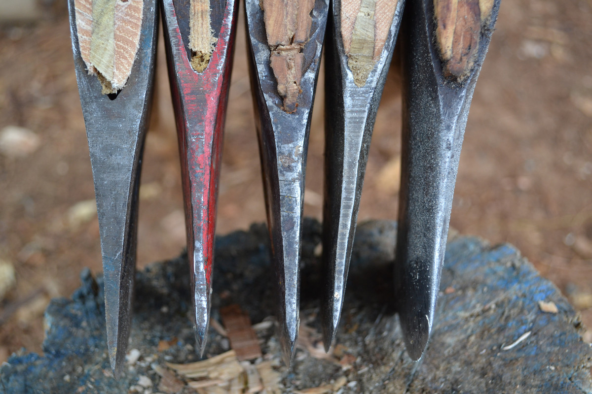

More in-depth, yes, you both were correct. The flat, wedge pattern of the Council is why it got stuck easily. Having a proud centerline and phantom bevels means only the very center of the bit will pinch, allowing you to lever it free with much less effort. I took this pic about 5 years ago to illustrate the ideal axe profile. Far right is best, far left is worst. I went through a spell where I only felled and processed trees with an axe and my back is aching just thinking about it. @davidwyby For a complete ax education, watch an axe to grind on Youtube. It'll teach you everything you need to know. Link to vid:
