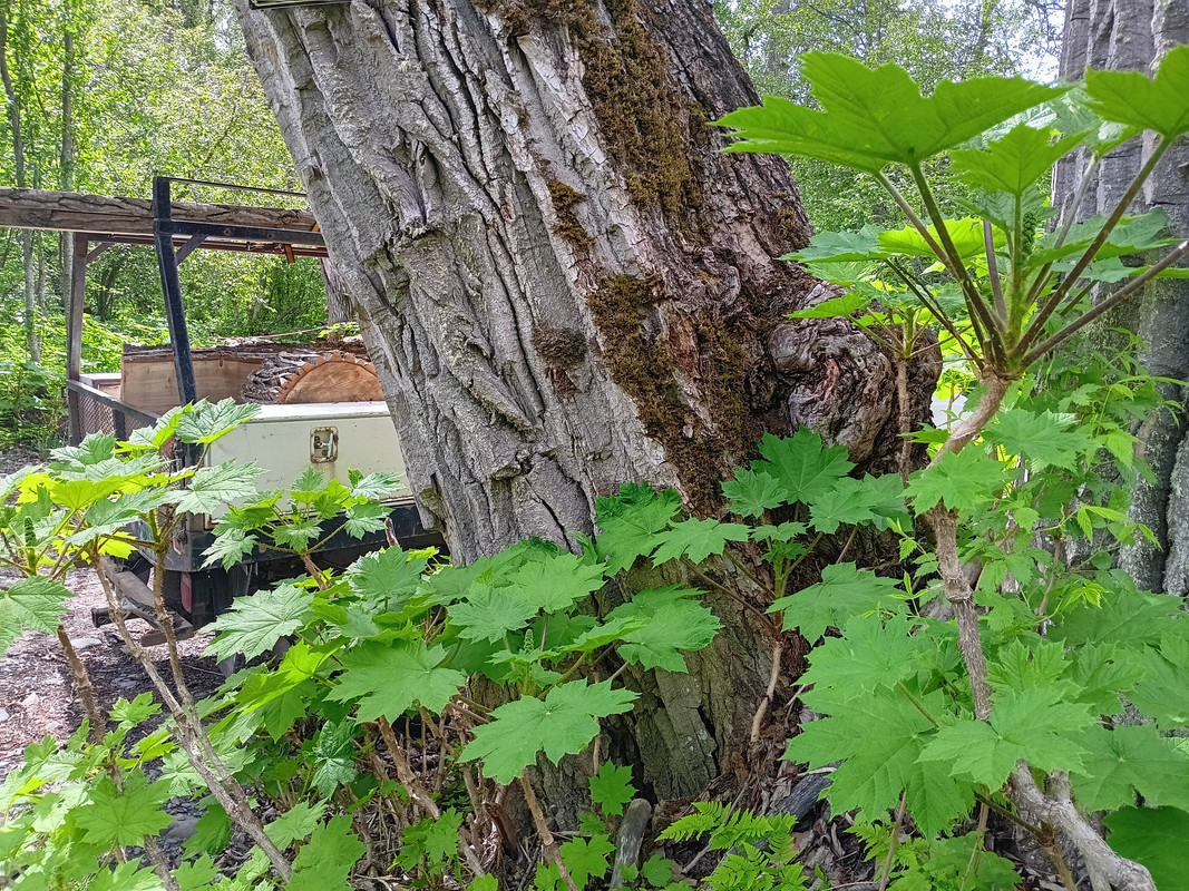

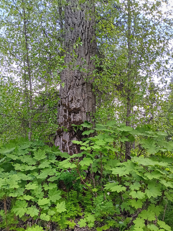

The big monster leaning one is gonna be interesting. Gonna have to plunge-cut from both sides with a 42" bar cleaning out what could barber chair. Come out of the cut, touch that sliver ah tension wood to finish off the back cut and hope for the best i guess.
Bark has crazy shag with half a foot ridges n saddles.
