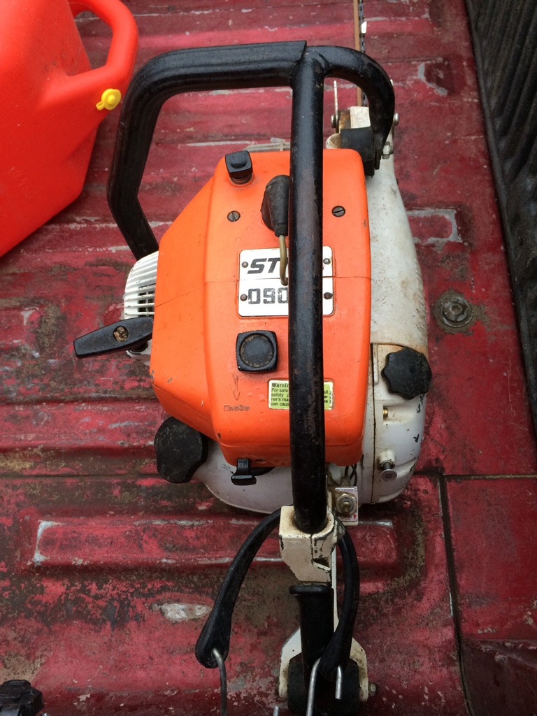

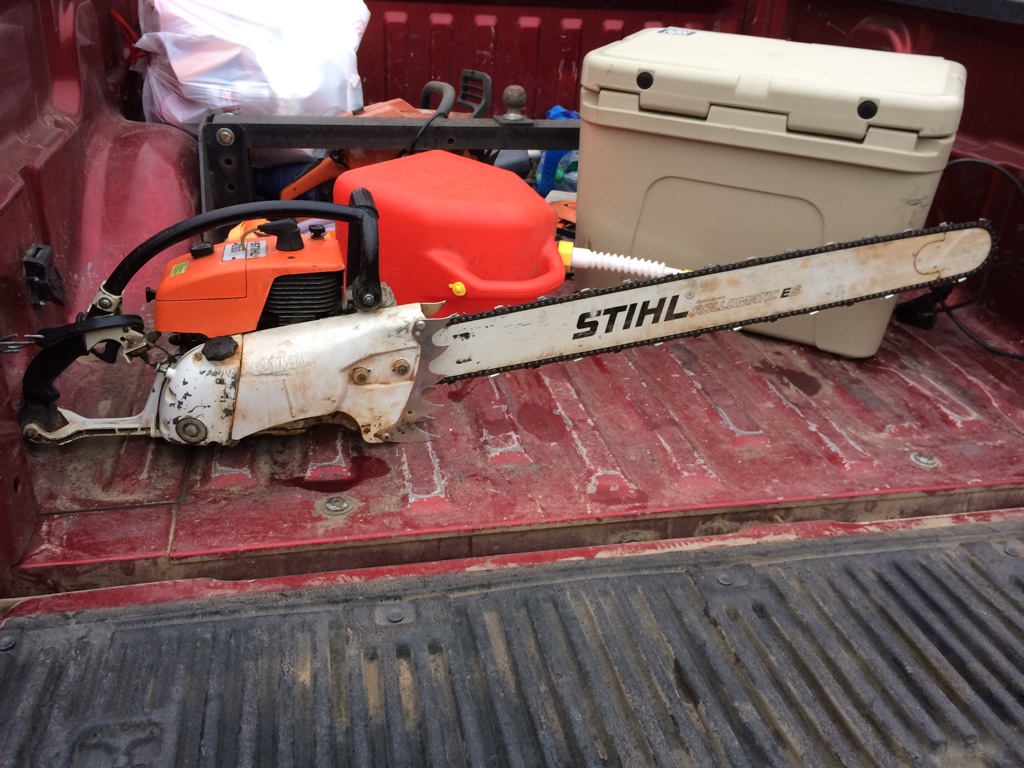

We than broke out the 090's to make some noise.
Mine ran of about a dozen cuts and died mid cut. Now wont run. Seems I have an issue to find but I thing something in the carb went wrong as it will start but refuses to rev up

Those old beasts are temperemental beasts sometimes, I'm told the same happens with women as they age too ;)
But once you get it ironed out you shouldn't have many problems, I've had a couple of 090 and 070 carbs that just wouldn't run right but a trip through the ultrasonic cleaner sorted them all out.
You just need to get it ported now, last one I did I set squish at about 30 thou, JB welded the decomp shut and flush inside the bore and just did a bit of smoothing, didn't mess with timing but man that thing ripped with the governor disabled!
Edit: oh and for the love of god eat your weetabix and fit a D handle starter!
