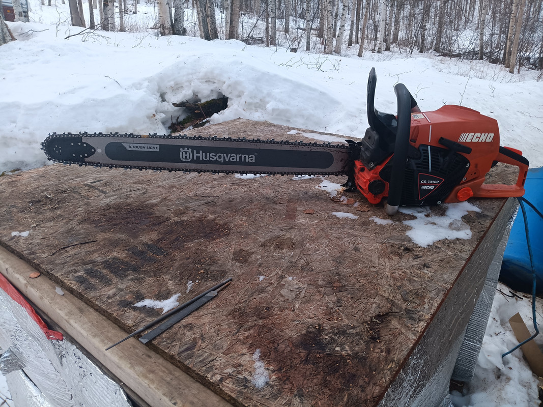

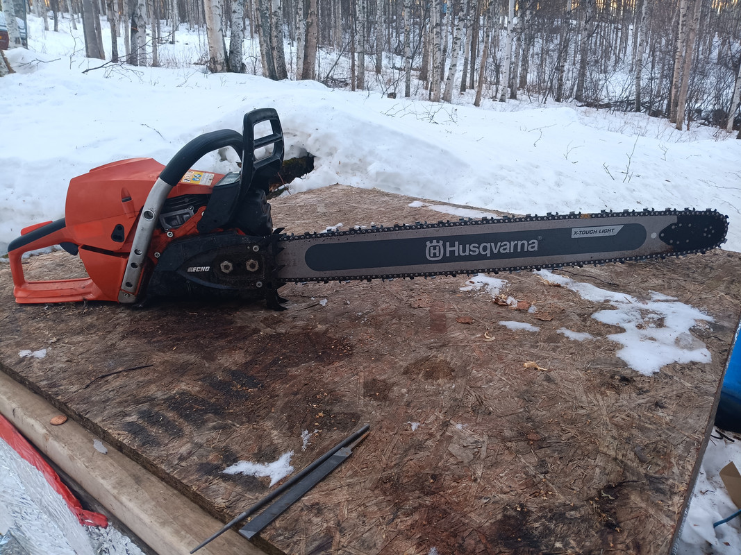

Things broken in a bit, leaning it out till burble cleans up in the cut.
Free revving bout 13,400 rpms. Definitely rev-limited.
Stock Husq C83 chain: Hits 12,000-12,400 rpm in dry white spruce, noodling or crosscutting. Just a bit of feed-pressure to keep the chain dug in.
I ain't touching those upper transfers, they feed just fine. Torque for days, oils plenty-good!

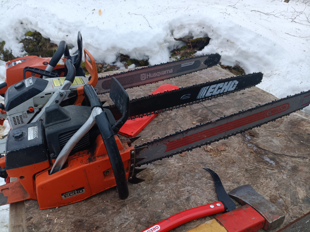

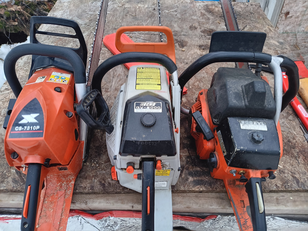

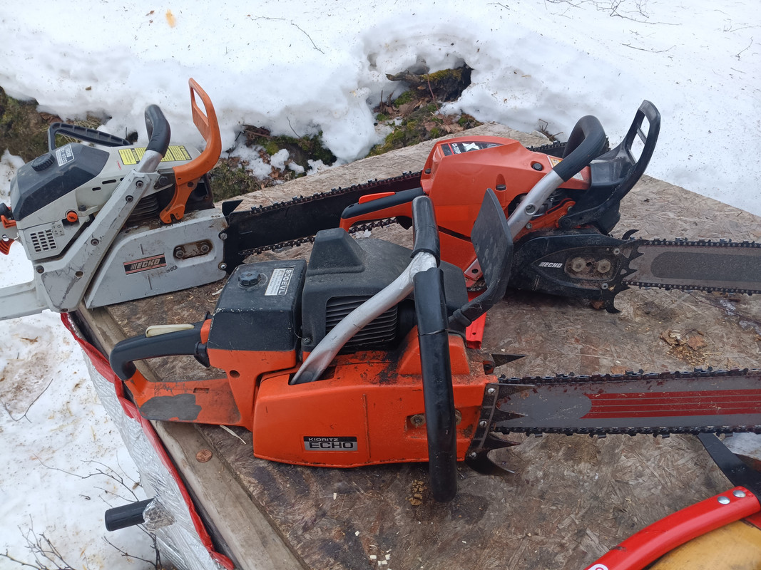

Was comparing this 7310p to a couple other saws I run.
Nothing precise, just saws full of fuel/oil/debris and set up how Id run them. All 3/8 .050 chain: EXL, LGX, C83.
The 7310p/32" husq light bar went 20 lbs
The cs 8000 went 24 lbs/36" echo bar.
The cs 900 evl/32" oregon went 26 lbs.

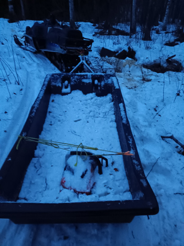

Lost the snow flap off the track tunnel. Saw gets burried with snow-spray every trip for wood. I think it was liquid wrench I used on the throttle and carb springs. The throttle cable hasn't gotten sticky again.
In cold weather a graphite type lube is the way to go.
