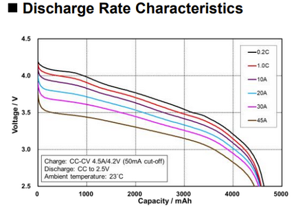

My experience with battery saws is they do a lot better in small cuts than large. My trim
saw can do hundreds of 3” cuts on a single 2.5amp battery, but only 3 or 4 of 10” cuts.
The likely reason for this is that the capacity of Li-Ion cells, like other electrochemical cells, depends on the discharge current. The standard discharge rate for which manufacturers quote the capacity of the cell is 0.2C, or 5 hours. For higher discharge rate, the capacity will be lower, due to the (thermal) losses on the internal resistance, which increase roughly in proportion to the square of the current.
An example of the discharge rate characteristics of a high-current 21700 cell:
