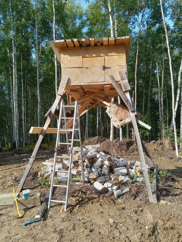

Alaskan food cache up on 16 ft legs. All milled spruce and some scrap roofing. Filled it with 2000 lbs of shelf-life dry goods. Food is good till year 2051. Still have to "bear-proof" the legs with metal.

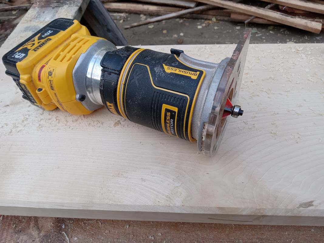

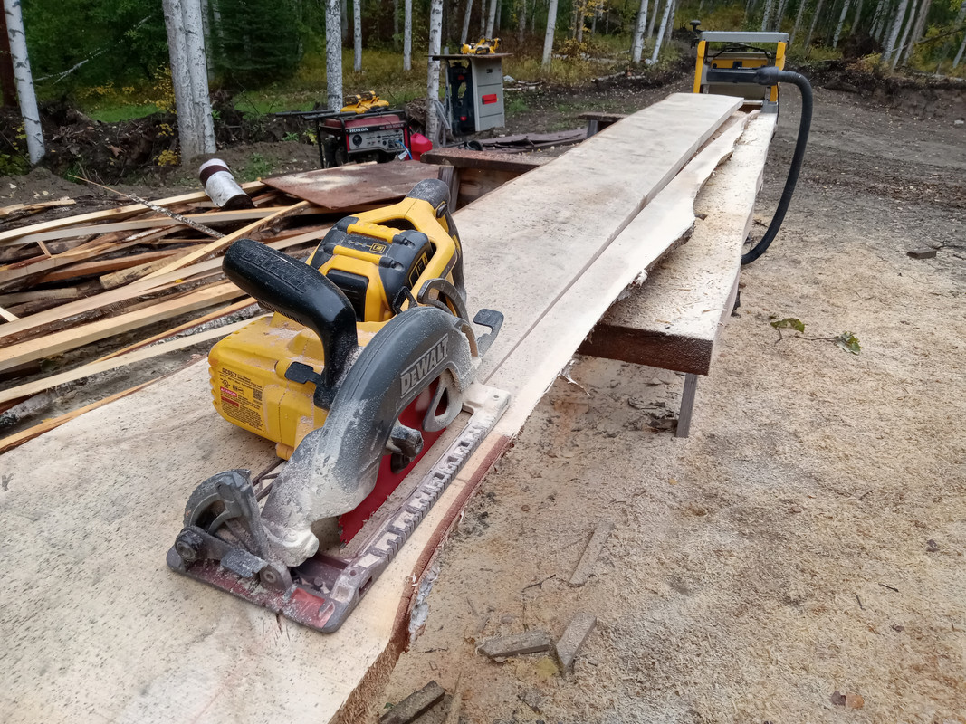

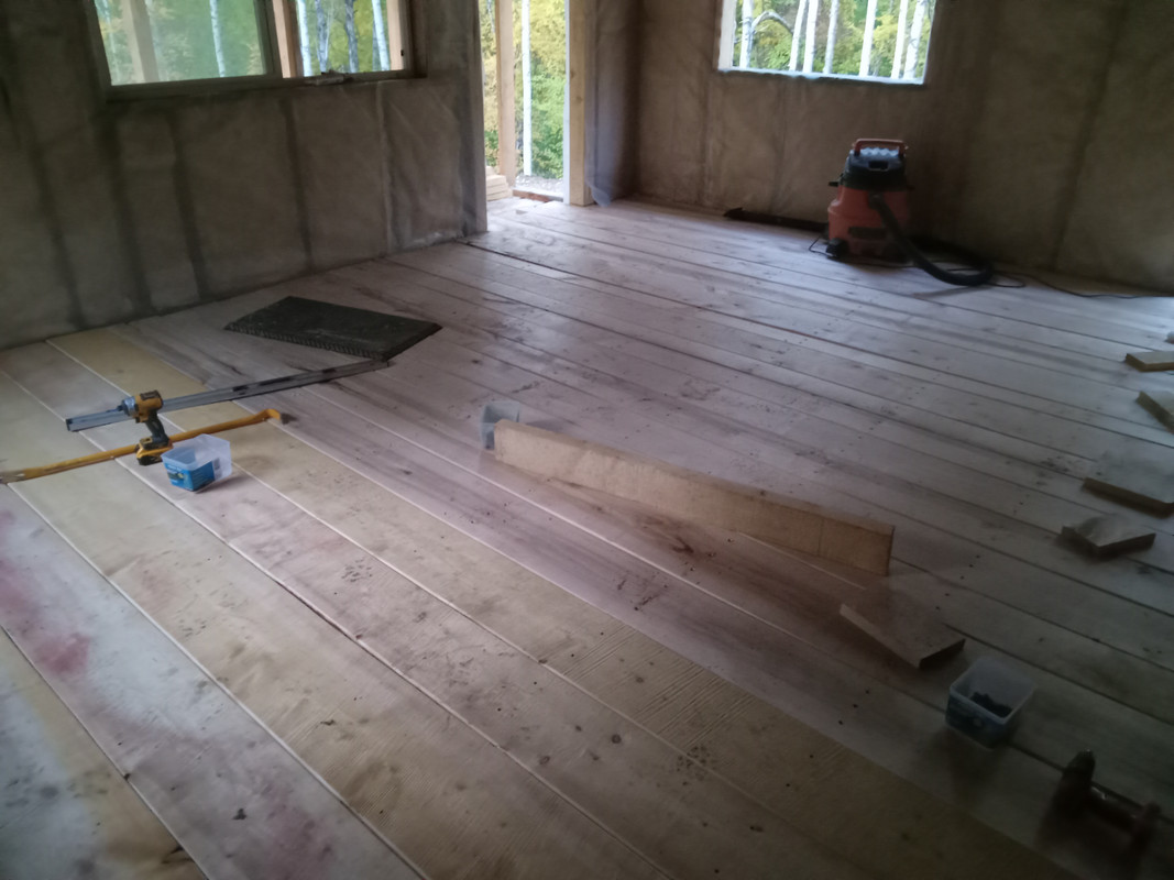

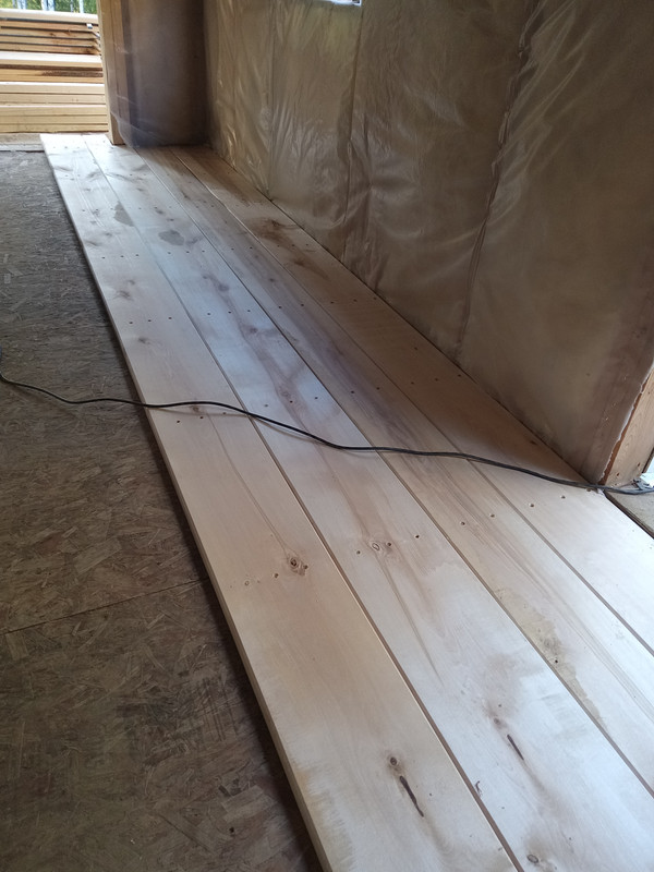

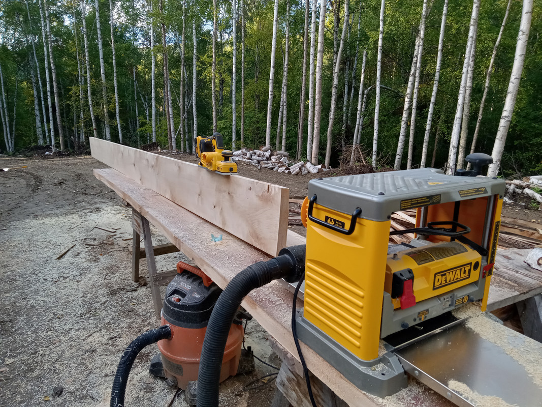

Got the alaskan birch flooring in. Still have to sand and seal with teak oil. Most was milled with a ported cs 6700 using 3/8 lp. One giant birch was milled with a ported cs 1201 with .404 cutters at 10 degrees.
After drying for 5-6 months, I planed it from 1.5" to 1.3". Edged it with a hand planer, beveled with a 60 degree router bit. I guess the flooring guys call this "wide plank flooring" and charge 2-3 times more than hardwood flooring.
mainer_in_ak
5:24 PM
22880
Mar 13, 2022
917
3,880
Interior Alaska
Torx screws countersunk every 2 feet.
Towards the end of the flooring(last 5.5 ft), I switched to spruce that hasn't been planed because that area will be covered by a wood stove, staircase and a firewood rack.
