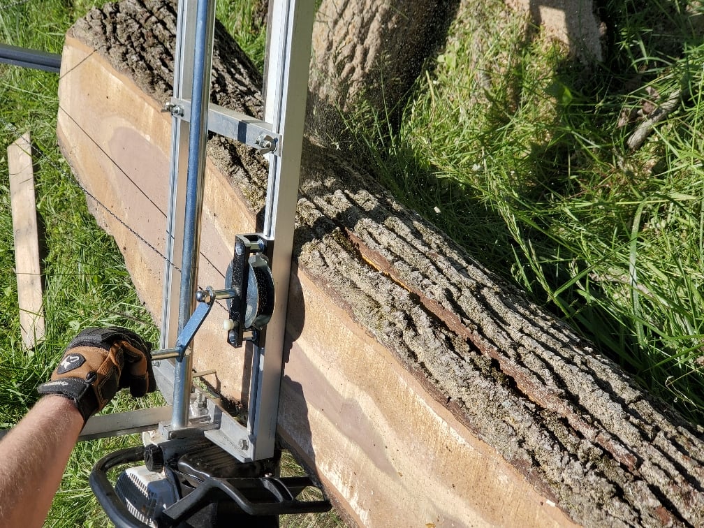

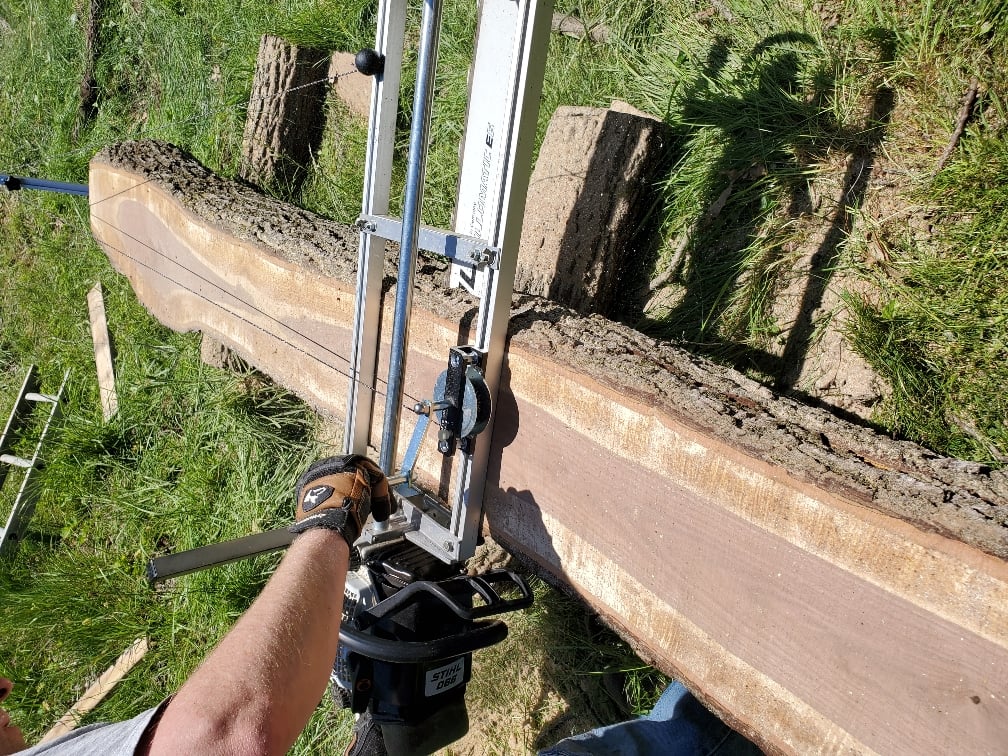

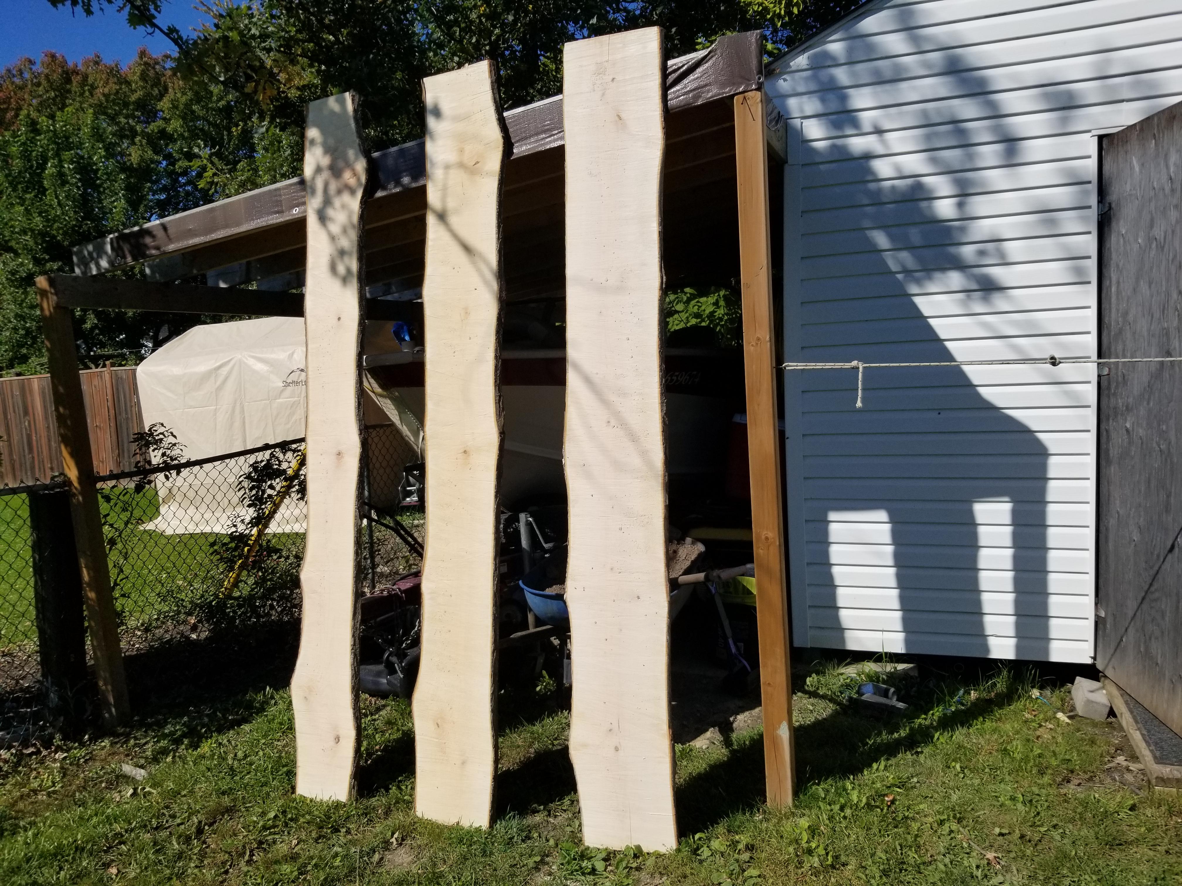

Got these mapke boards made today. Got three more logs to work on, two maple and a walnut. Just make a few boards a day and its not too bad.

I do. I got the Granberg winch because I didn't want to build my own. It definetly helps with the strain on the body.
That looks a lot easyer lol.
Does that have any gear reduction? Looks like its just anpully with a handle welded. If so a cheap guy like me could make one.

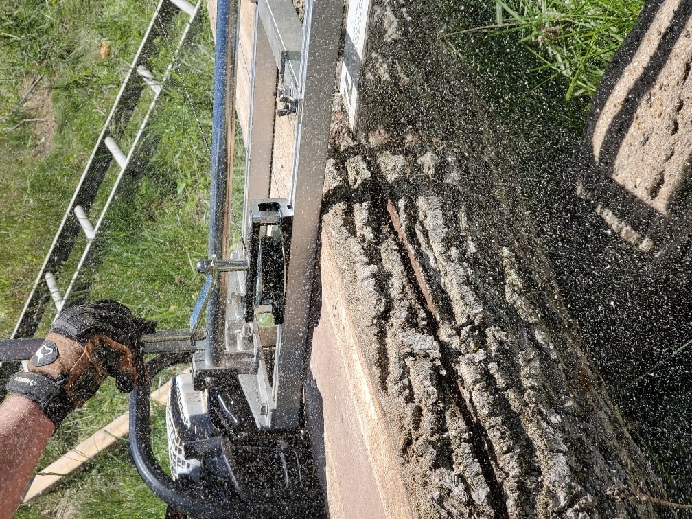

So whats better? To push mill straight down the log or go like a seasaw. It seems way quicker going like a sea saw vs straight down.

I seesaw when I mill, especially if the slab is hard and wide.
I think it puts less stress on the saw, and leaves a more attractive pattern.
I don't plain the wood, or fully sand the lines out.

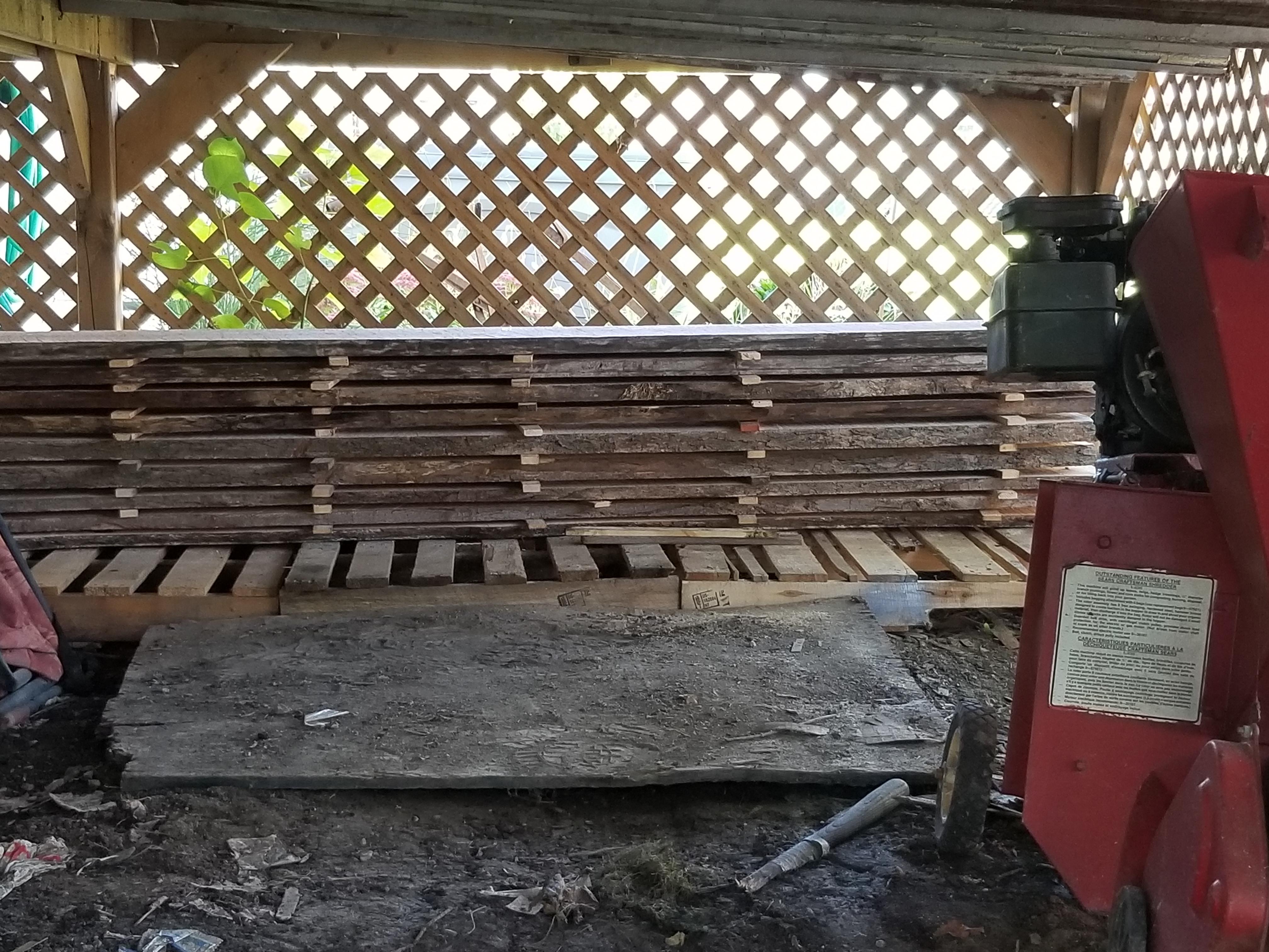

Finally got a spot set up tonstacknthe boards out of my way. Under the deck. I put tin up as a roof years ago so it wont get rained on.
Now I am at a stabd still. I ran out of fuel lol. The saw sure does like to drink
