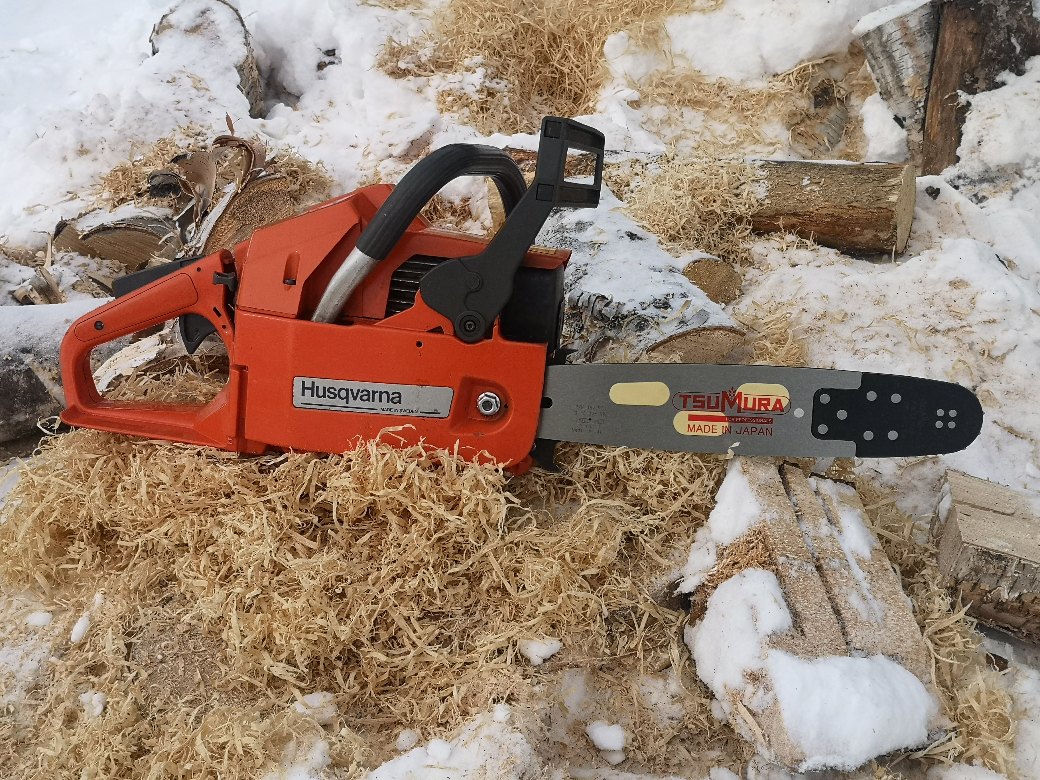

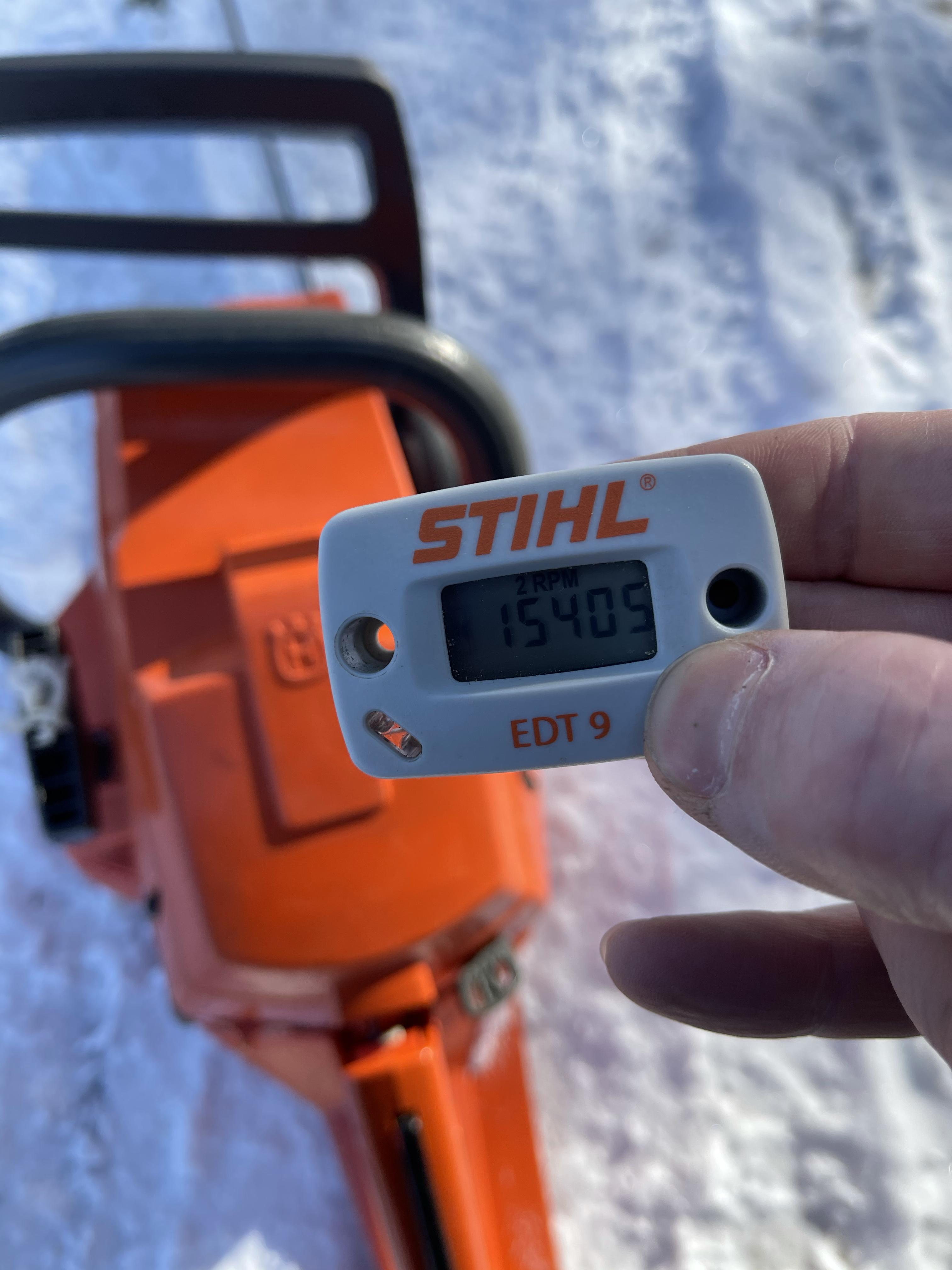

This just showed up today. Still need to get a chain, but I couldn't resist putting it on the 42 for pictures...
As for your 242, you may find it has a sweet spot a bit richer than it takes for 15,500. Spec in the cut is 9900.

Did you buy the bar from Sven Junghans aka Skogsverktyg.se? I have a couple of them myself, it's been a few years since I felled on the farm, who knows, maybe I'll get to test them out myself this year.

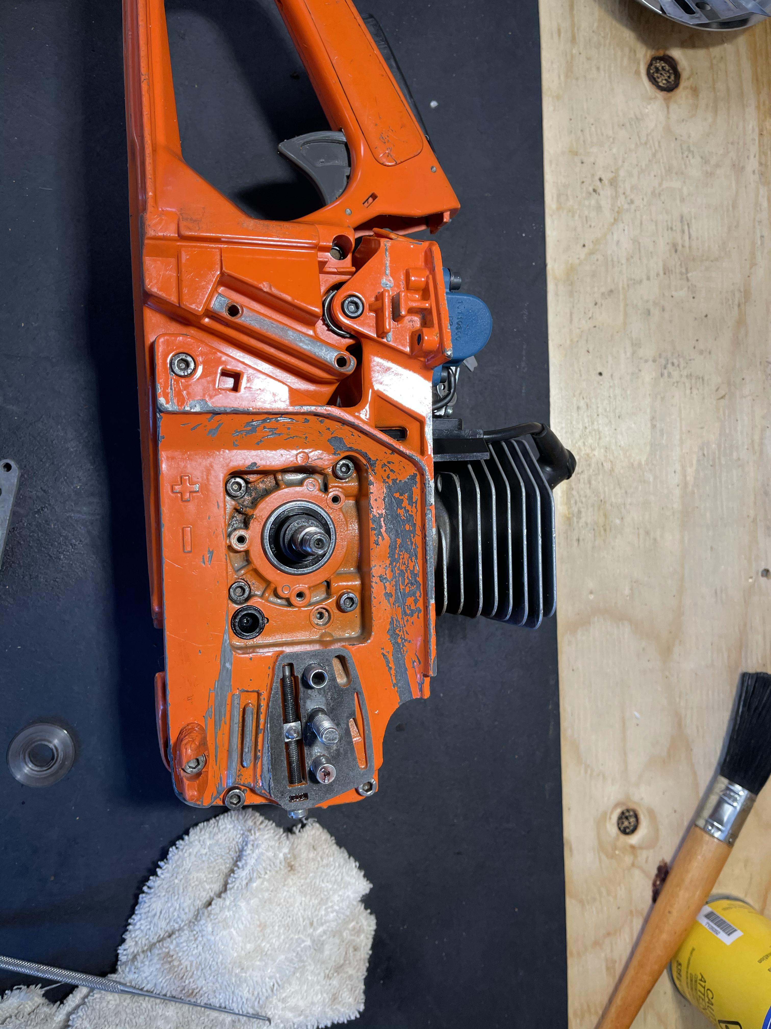

Speaking anniversary models, here is the 242 I just finished disassembling, cleaning and putting back together. Seals and bearing were both fine so no need to split the cases this time. 15" NOS Oregon bar adds the finishing touch. I do have a NOS muffler for this but I didn't want to hack it up so I modded this one and painted it. Anyone have a good tip on how to properly glue the corner of the decal down on the top cover?

No tips but that saw is a beauty!!!!!
