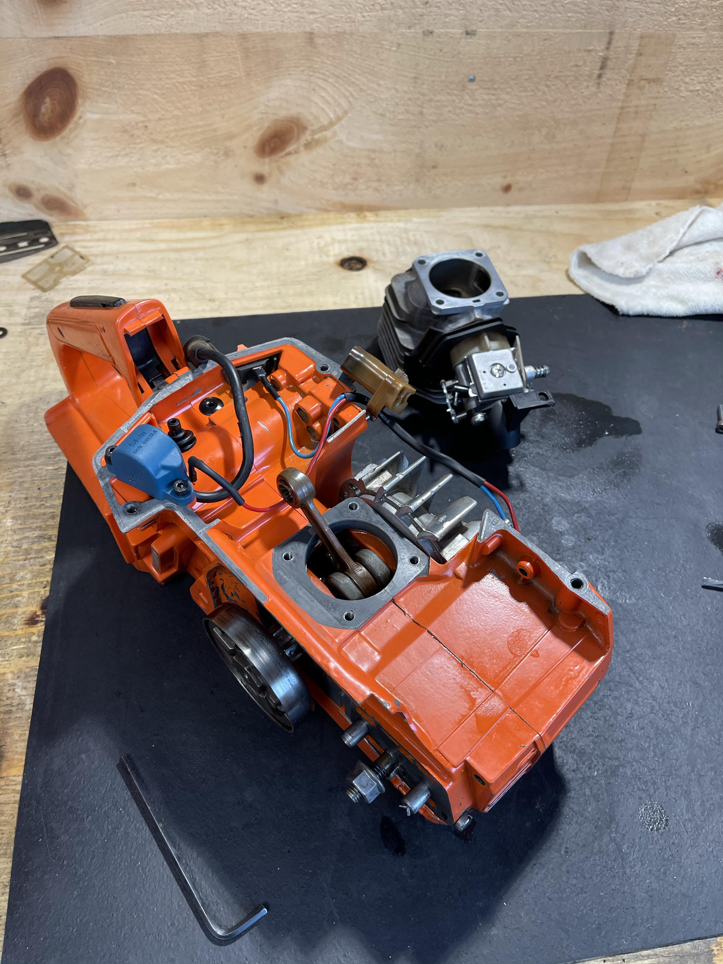

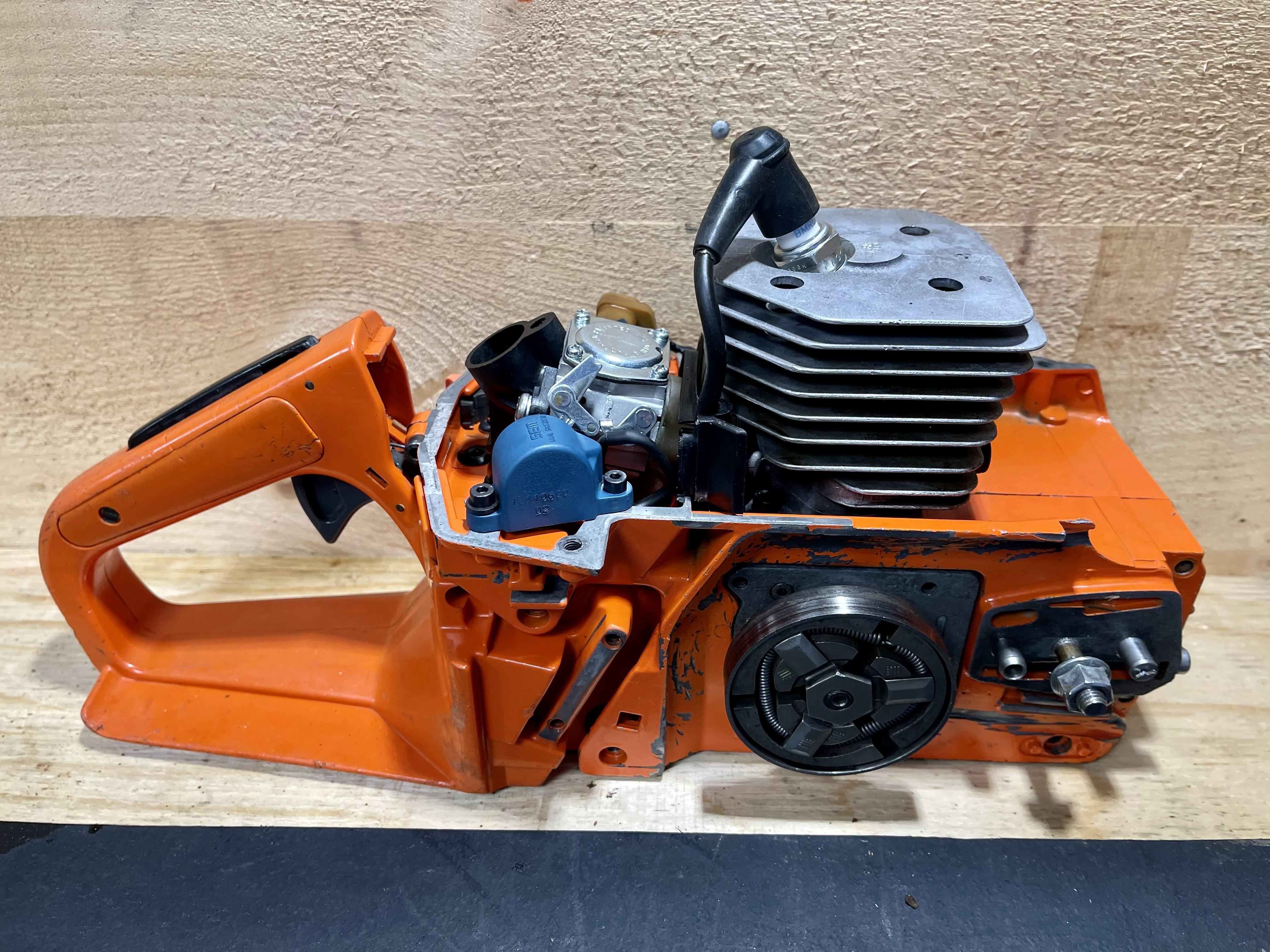

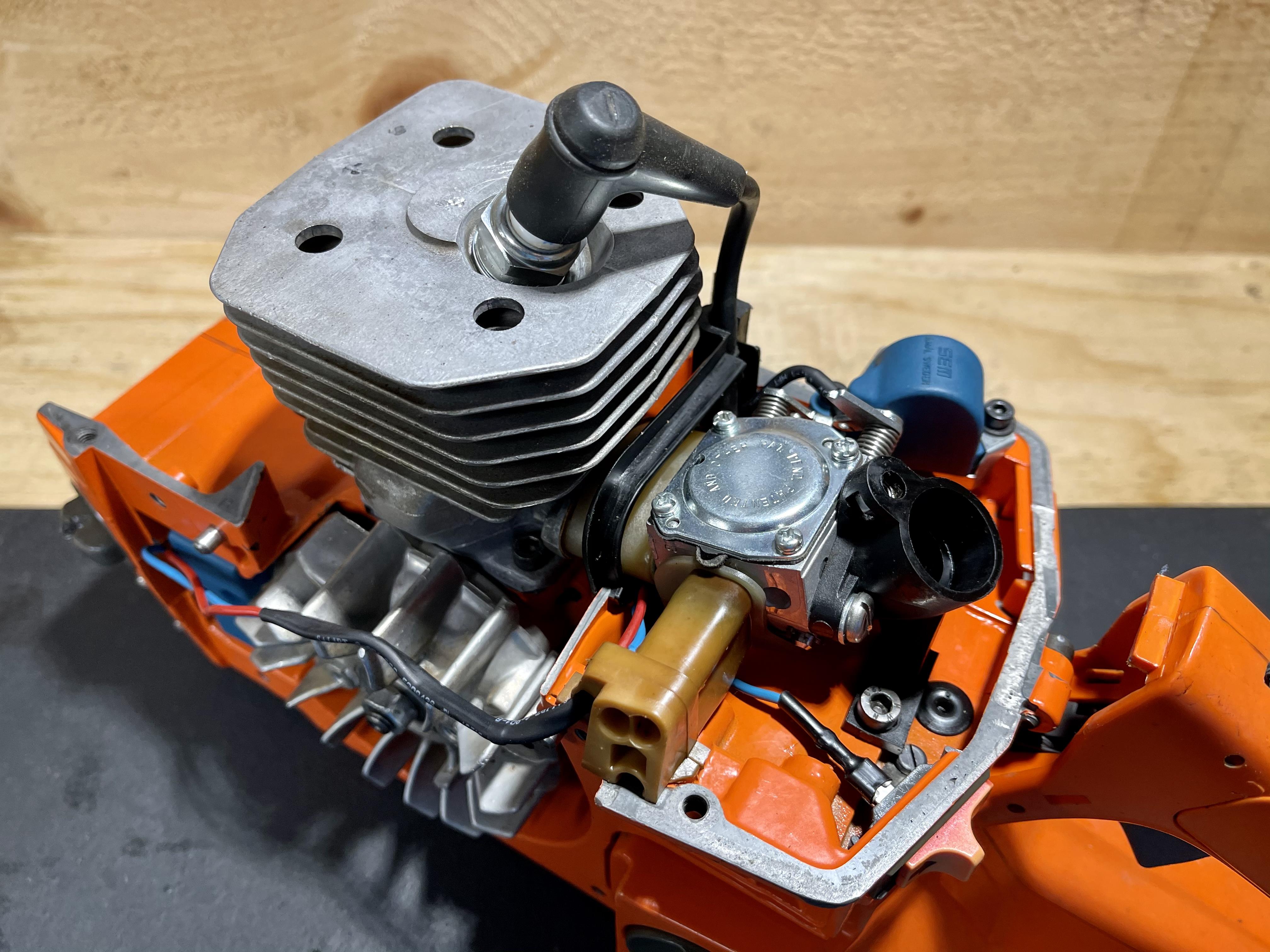

Thanks boys that’s super kind of you - still lots of work to go waiting on a few NOS items

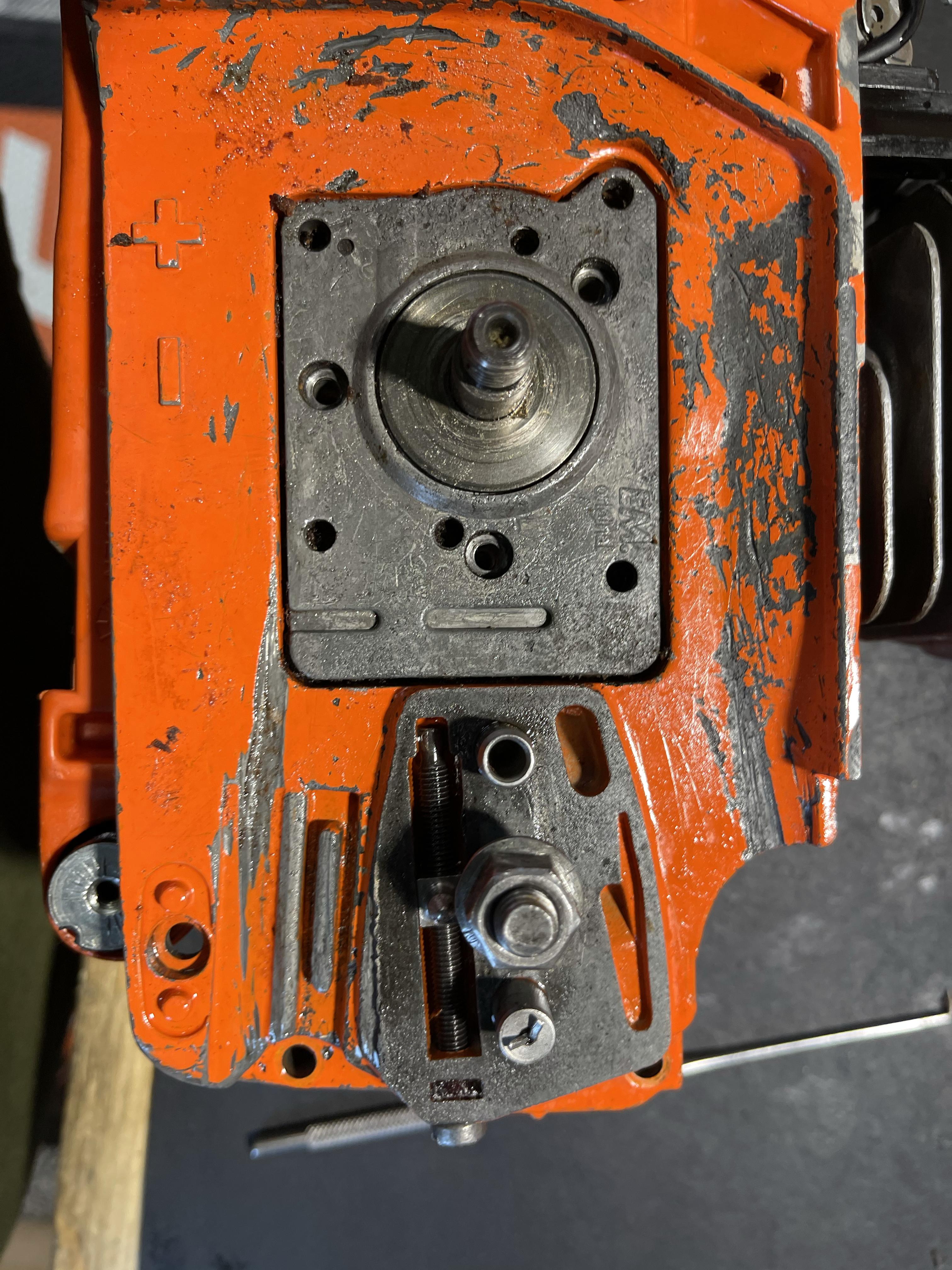

Can anyone give me some pro tips on how to remove the oil pump? She doesn’t seem to want to budge - my first time doing one
The two holes at 10 oclock and 4 oclock should be threaded. Just put a screw in each hole and jack the pump up off the crankcase.
