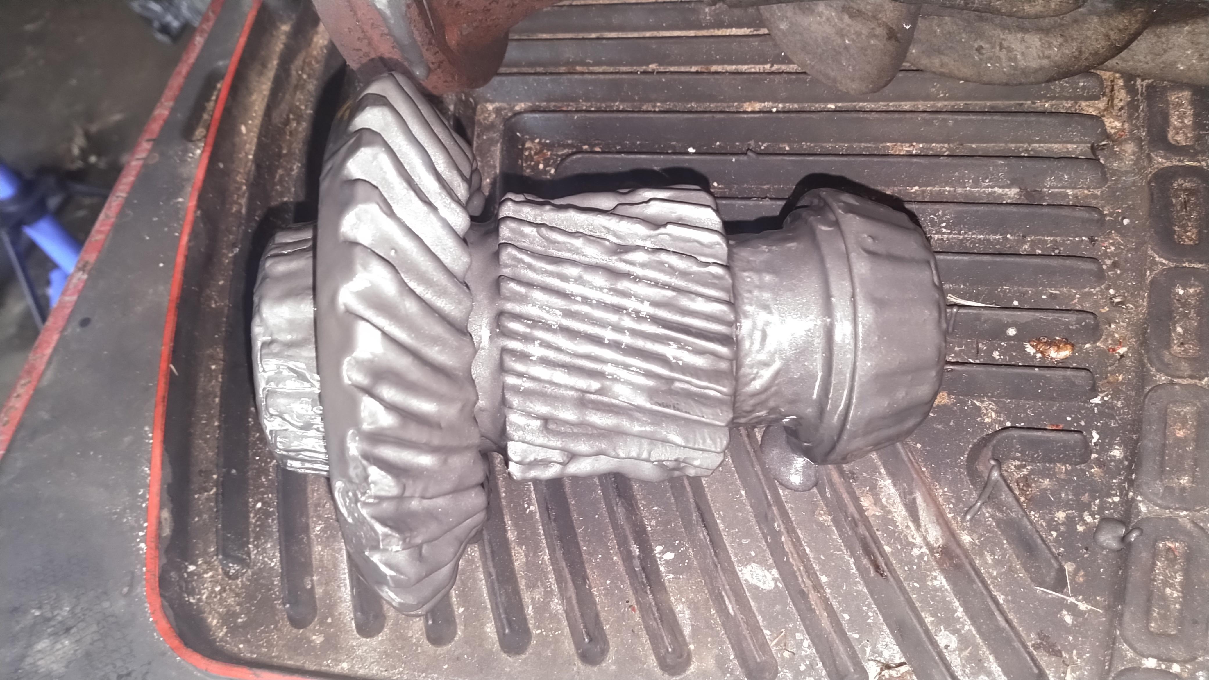

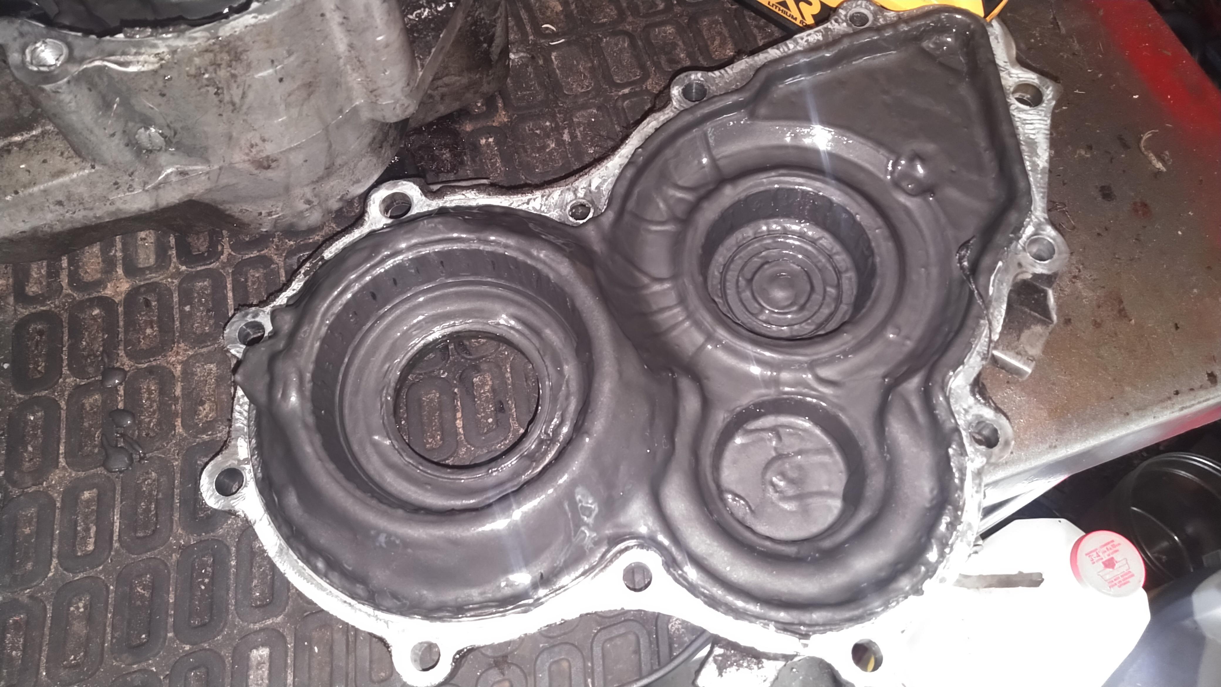

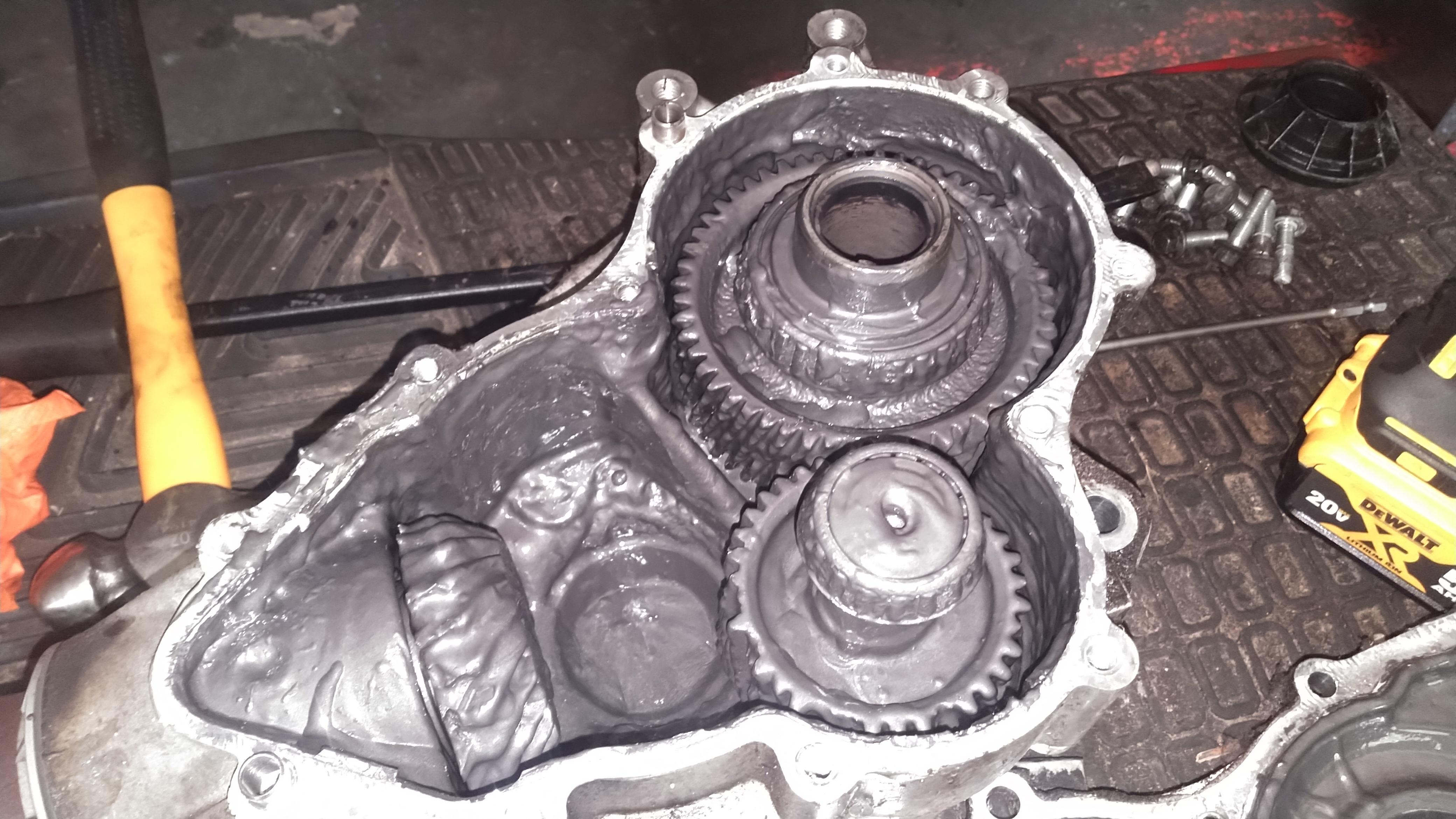

Here's the blown up PTU from my 06 Escape Hybrid. Filled with a mix of burnt 75W140, aluminum shavings and gear chunks..
