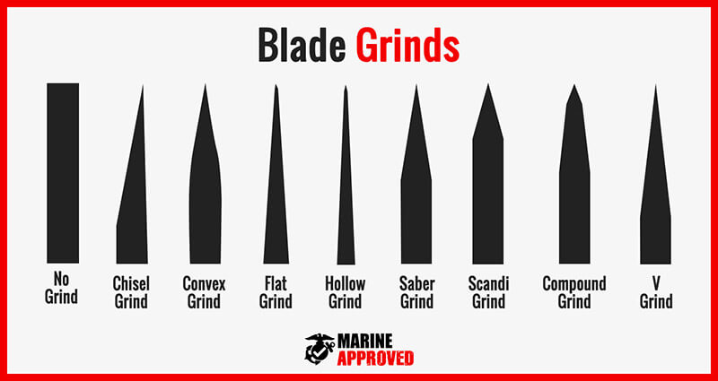

It has none of the properties of a square filed/ground chain. It doesnt have the cutting angles or chisel corner. It has the same angles as any round filed cutter.
Every demonstration I have watches have had about the same cutting speed as round filed.
No chance I will pay for stihl hoax chain.
Not true.
Hexa (top plate) has a "chisel" grind, just like square. Does the angle change at the sideplate corner, no it does not but those top plates themselves have the same geometry.
Hexa is in no way same angles as a round ground/filed chain. That would be hollow type grind, its round... not straight.
images
Hexa just takes the flat profile of the top plate and goes straight through the sideplate with it.

I was trying to explain that, I said hexa chain had a straight edge compared to the concave of round filed, thats the only difference.
The proffessional terms well I have no clue... o_O
Anyway I am starting to feel like a parrot.
Not true.
images
