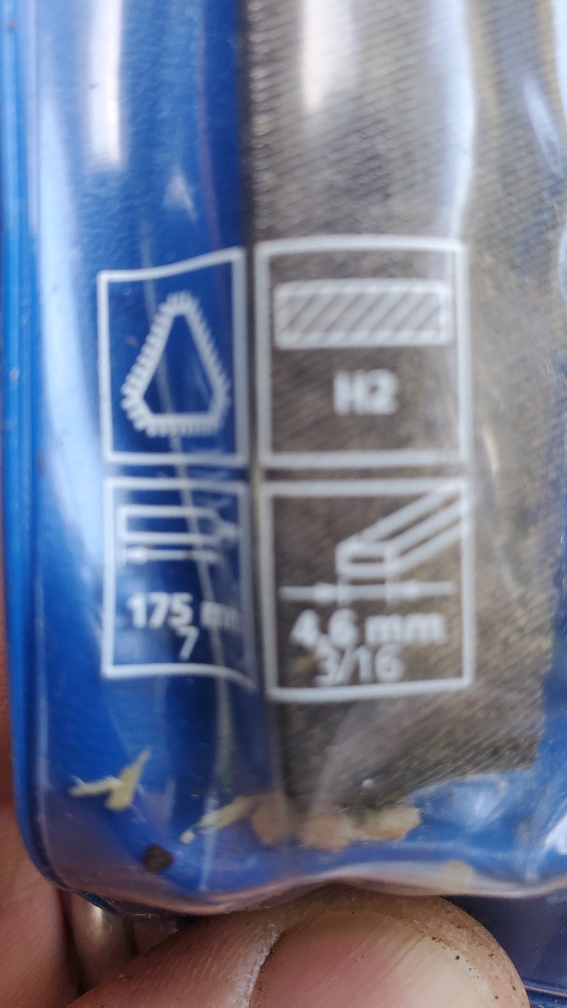

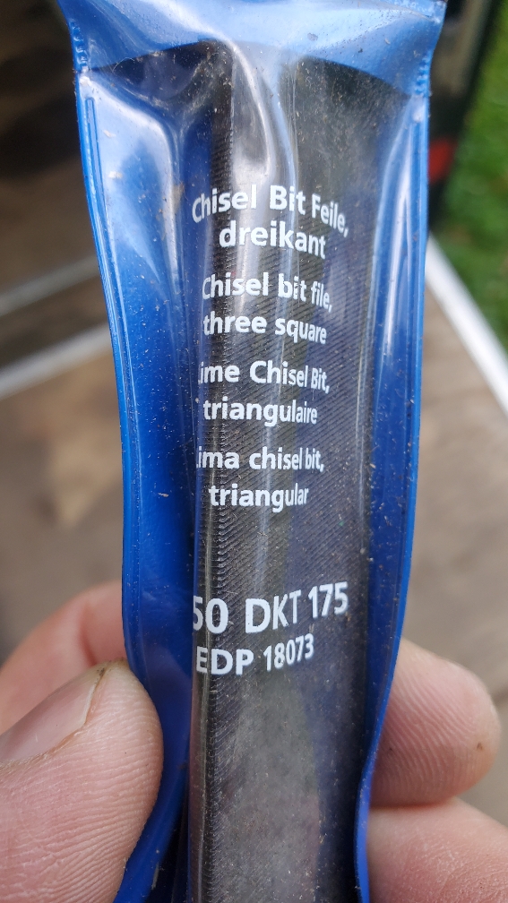

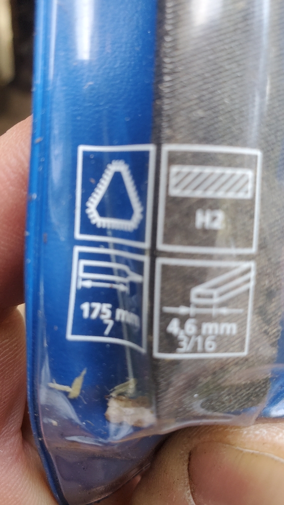

Hey buddy, I thought that looked weird. Afaik thats a file for square filing not stihl hexa.
Hexa file should be an even sided 60 degree file with two smooth sides without cutters wich you lay flat against the gullet.
Triangulare' !
The Hexa file I got came from Sweden.
It has not been put to the test as new chain is sampled.
The file does lay perfect under the top plate, sets on the side plate and the gullet.
It is pretty awesome.
A few strokes and you are gtg.
This Triangulare' is a one and done deal.
Sent from my SM-N975U using Tapatalk
