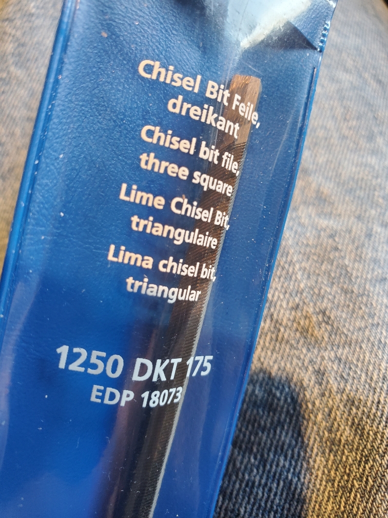

No live action yet, but the
Pfered triangle chisel bit has 6 cutting sides. It lays nicely under the top plate and in the gullet.
The file took 12 days to arrive via postal mail from AUSTRALIA.

Nice. Pics & vids please.
