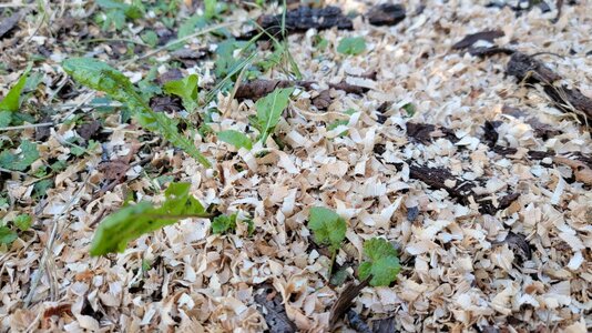

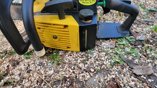

Just played around with a brand new EXL, on the torque monster from the North Woods factory. @Stump Shot
Cut was made on a 5 year bone dry hard wood, these were the chips we pulled. Stock tooth profile, stock raker height, but I did modify the raker profile just to see how we would do.
Just as many VARIABLE rakers on this chain as on my C83/85 set up out of the box.
The tip was bouncing in the hard wood as expected, when pinned down by the dogs, she held steady.
