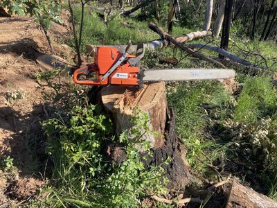

I low cut oak stumps for 3 hours today with the G395xp. Only came up with one issue that I can see. It seems like when the saw get’s down to about half a tank of oil (cutting sideways) the pickup doesn’t drop to the bottom of the tank and the saw doesn’t oil well. Works fine cutting right side up. You guys think a new OE pickup tube would solve this problem?EDDDC4D8-22A0-417C-A411-AB338A2CE96A.jpeg

I low cut oak stumps for 3 hours today with the G395xp. Only came up with one issue that I can see. It seems like when the saw get’s down to about half a tank of oil (cutting sideways) the pickup doesn’t drop to the bottom of the tank and the saw doesn’t oil well. Works fine cutting right side up. You guys think a new OE pickup tube would solve this problem?View attachment 419806
take the cap off and look in there. see what it does. maybe its hanging up on something. that brass filter is pretty heavy for that tubing to not jet let it fall down. maybe the tubing is worn and its just bending in half kinking.
I checked my brother's oem 395, the oe pickup tube flops to the bottom of the tank very nicely when the saw is on it's side. Long story short, yeah, I think that would probably cure it.
That’s what I figured as well, but when I look in there the brass thing is sitting atop the oil every time 🤷‍♂️.

The oiler gear hasn’t failed on me yet but I assume it will at some point. For some reason that pickup just doesn’t flop down like should, it rides up in the top of the tank. Maybe the rubber is too stiff, who knows! I think I’ll give the OE pickup a try see how that goes.
