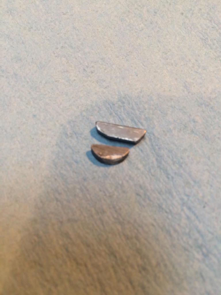

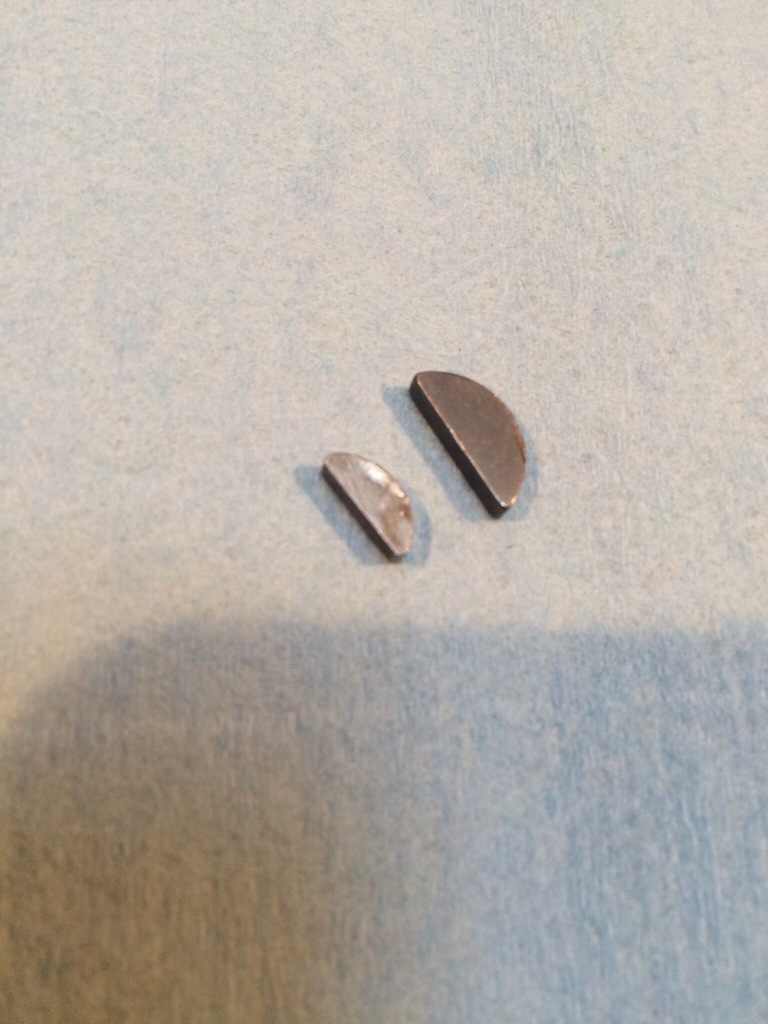

Well, I figured out the problem with my carb! I was doing another leak check for a vacuum leak and I noticed that the intake block was not able to seal. I took off the metal ring that surrounds the intake rubber and it sealed up fine. I had an oem ring and compared the two.....
Put the oem in and it runs! The Huztle is %50 thicker and was leaning it out.
