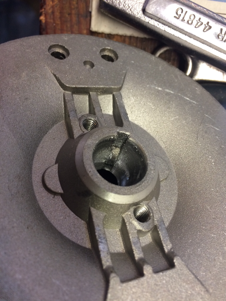

Go back and check your flywheel nut. Use blue Locktite to boot.
schmidteo
12:54 AM
857
Feb 11, 2016
26
39
Michigan
Dang! Thanks Driver. I just put the last bolt in the recoil cover in five minutes ago! I'll pull that nut and get some locktite on it asap!

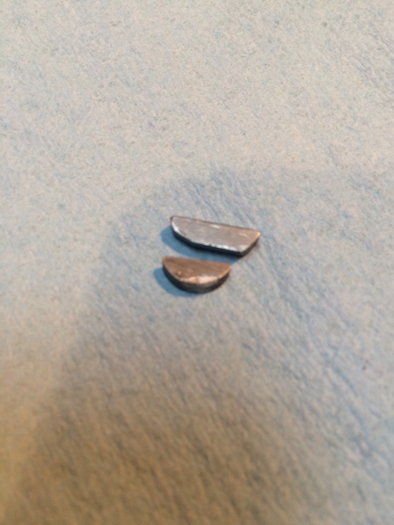

Get a flange nut. Not the plain hex nut contained in the kit.
I'm going to make a tapered key to use as much of the keyway as possible. About 5/16" long, tapered from 3mm square.

Modified a 3x7x5 mm woodruff key.
External star lockwasher under the nut and blue Locktite.
