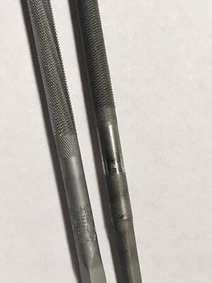

Bahco-Öberg (left) vs
Stihl /Pferd Classic (right)
Both unused .
Both of the aggressive / coarser type ( second cut )
of chainsaw round files,but nevertheless the Bahco-Öberg
removes more material ,while the Stihl achieves a smoother
cutting edge .They both share about the same service life ,that is one to maybe two chains ( depending on the user ,mainly ) .
